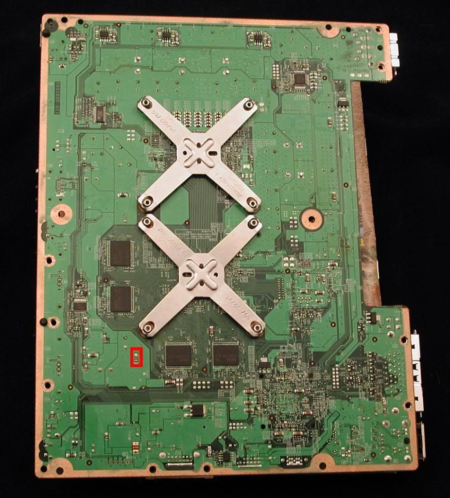

Also a clients xbox has the C3U6 "resistor" (brown rectangle) knocked off. All of the 360 works except the dvd drive. Any clue if this really is a resistor and what the value of it is? (sorry didn't want to start another thread)

Here's the pic, enlarge it and the small brown rectangle in the red square is the piece that is knocked off. The motherboard has "C3U6" printed next to it.
i have no idea what that piece is lol. if you can turn it on and get to dashboard then you should be good. if its a lite on and its not ejecting then you might have had a bad flash.
like i said, confirm the dvd brand and i can continue to help you from there =)

Sorry I never got back to you, got called into work. The drive is a samsung, but I think I found out what that part is from here. The piece knocked off looks exactly like a "0805 Capacitor" capacitor according to the guide so I will try that soon and report back
