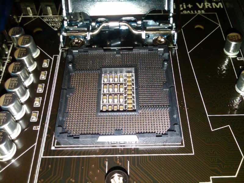

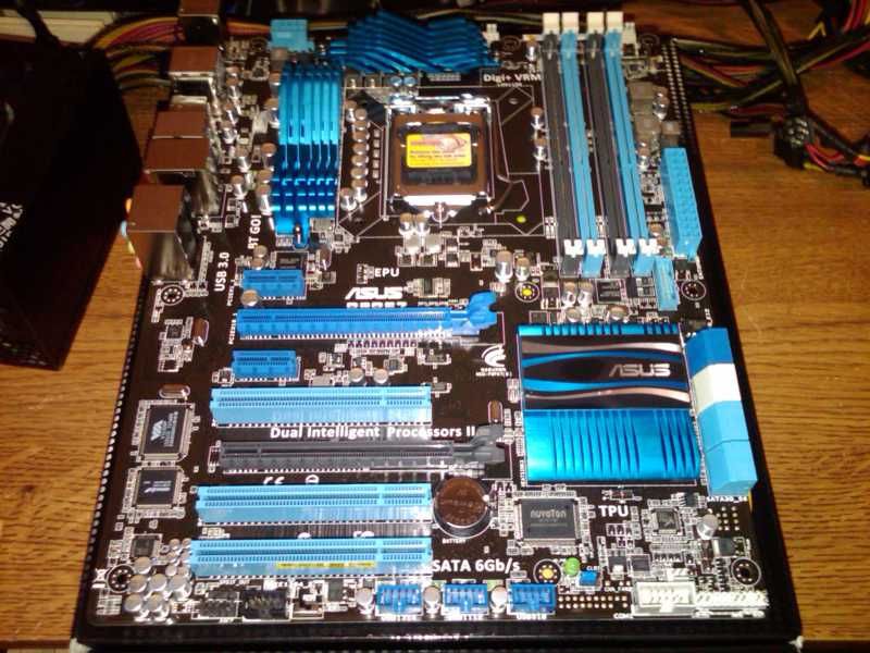

Yep.. That's right. I mentioned in another thread that for some reason I thought SB was to be released today, Jan 6 but I was wrong, it's the 9th. That however did not stop me from calling up a few friends who work at retail shops.. Afternoon coffee break today was a spendy one. I'll apologize for the poor quality pictures, I had planned on buying a decent camera this month, but that'll have to wait now.
Thats the new bits, 2600K, Asus P8P67, Corsair 4GB Dominator 1600Mhz and a 500GB WD Black Sata 3.
Took the PSU out of my GPU rig and although SB has integrated graphics, only the Asus H67 chipset makes use of it, this being P67 I still require a discrete card, and since this is planned to be a dedicated bigadv rig, a GT240 is going in for now.
Onto unboxing, and yes I'll take more crappy pics. We should have some real world PPD numbers in a little while. I only have the stock cooler, so not sure how much I'll be pushing it just yet..
