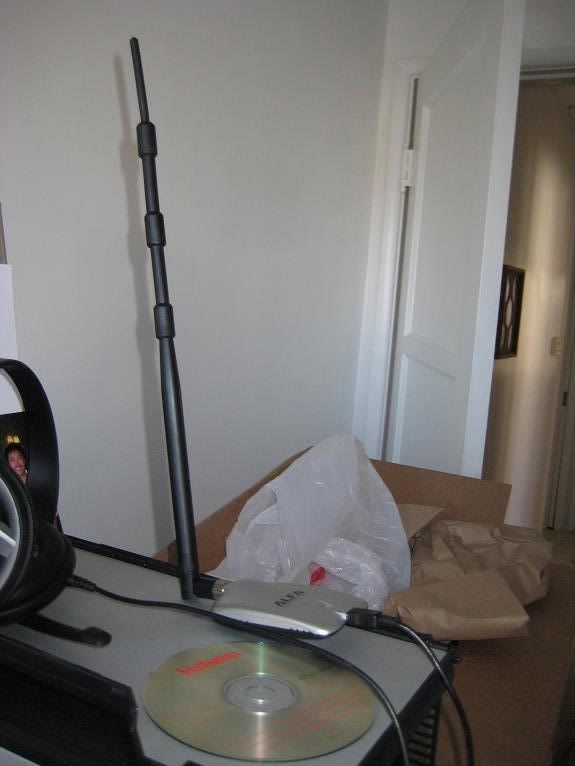

just get some really big antennas for the wireless router, like 15 dbi. then equally as big antennas on the wireless cards. you should be ok.

I wonder what that guy is doing with a Alfa 500 and 19dbi antana!
Yeah, there is no need for that antenna, at all. At least not in any normal circumstance like these.
I was wondering the very same thing.

That picture is a joke right?

I have that same usb wifi adaper with a 9dbi antana. It's the best portable usb packet injection wifi device on the market.
