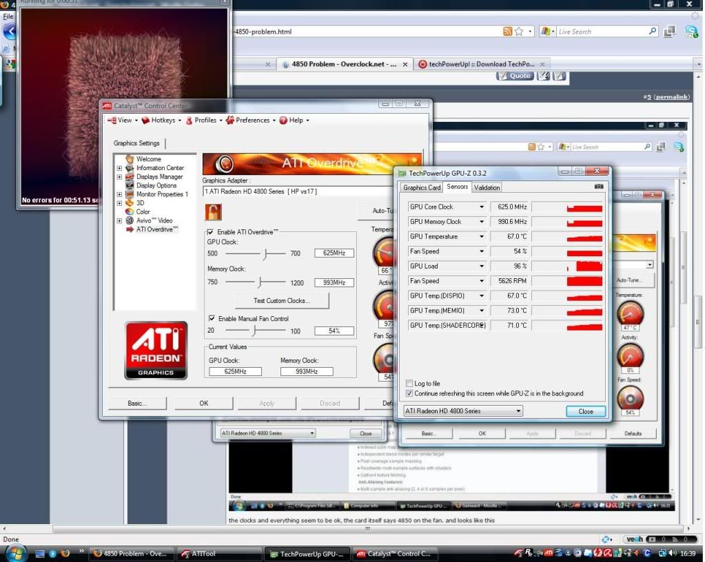

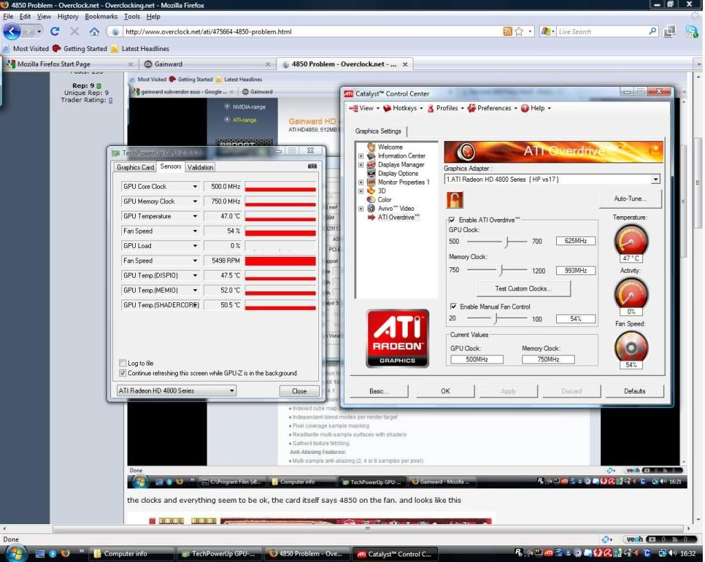

this image shows the card has different readings
Where? They match perfectly.
I think he means the first pic lol >< and i am fairly sure your card is just throttling, when you put it under load it will go back to highest clock speeds.
it says GPU clock 500HMz and memory, 750MHZ. They should be 625 and 993MHz
*sigh*
No.... they shouldn't be.
It's in 2D mode because you're not in a game. All video cards downclock when they're not in 3D mode.
yep, underload it goes to its orignial clock speeds.
