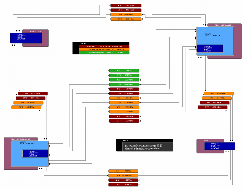

As you may recall from my previous update, I'm running three
VMs on this machine, two of which are pretty much always on
(the media VM and my personal VM), and the third of which is
only active when I'm pulling a backup of my dad's work
machine (apollo-business).
NOTE: I know there's lots of text and stuff in my
screenshots and it may be a bit difficult to read. Click
on any image to get the full-res version for improved
legibility.
The storage setup has been revised somewhat since the last
update. I now have a mirrored ZFS pool in ZEUS for backing
up my dad's business data (so, in total his data is on six
HDDs, including the one in his work machine). His data is
pulled onto the apollo-business VM from his work machine,
and then pulled onto ZEUS. The fact that neither the
business VM nor ZEUS are online 24/7 (ZEUS is turned off
physically most of the time) should provide some decent
protection against most malheurs, the only thing I still
need to implement is a proper off-site backup plan (which
I will definitely do, in case of unforeseen disasters,
break-ins/theft and so on).
(click image for full res)
The Plan
For convenience's sake, I was planning on using NFS for
sharing data between the server and its various clients
on our network. Unfortunately, I was getting some rather
disappointing benchmarking results initially, with only ~60
MB/s to ~70 MB/s transfer speeds between machines.

Networking Benchmark Results
Initially, I got only around 60 MB/s for NFS, after that the
next plateau was somewhere between 75 MB/s and 80 MB/s, and
lastly, this is the current situation. I must say I find the
results to be slightly... peculiar. Pretty much everything
I've ever read says that NFS should offer better performance
than CIFS, and yet, for some reason, in many cases that was
not the result I got.
I'm not yet sure if I'll be going with NFS or CIFS in the
end to be honest. On one hand, CIFS does give my better
performance for the most part, but I have found NFS more
convenient to configure and use, and NFS' performance at
this point is decent enough for most of my purposes.
In general, I find the NFS results just rather weird
TBH. But they have been reproducible over different runs on
several days, so for the time being I'll accept them as what
I can get.
Anyway, behold the mother of all graphics!

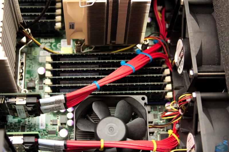

Lastly, I've repurposed the 2.5" drive cage from my Caselabs
SMH10; cleaner than the rather improvised mount from before.
For the time being, the build is now pretty much complete.

Final Pics
So, some final pics (I finally managed to acquire our DSLR
for these):
That Caselabs drive cage I mentioned. The top drive is the
WDC VelociRaptor.
And some more cable shots, because why not.
Looks much better with all RAM slots filled IMHO.
It's kinda funny: Considering how large the M/B compartment
actually is, it's pretty packed now with everything that's
in there. The impression is even stronger in person than on
the pics.
Thanks for tagging along everyone, and until next time!
