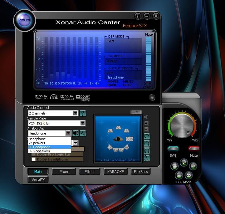

You should be able to select Front Panel like this:
Thnx a lot! +Rep. I didn't know what FP stood for, thought it was some sort of optical output.
