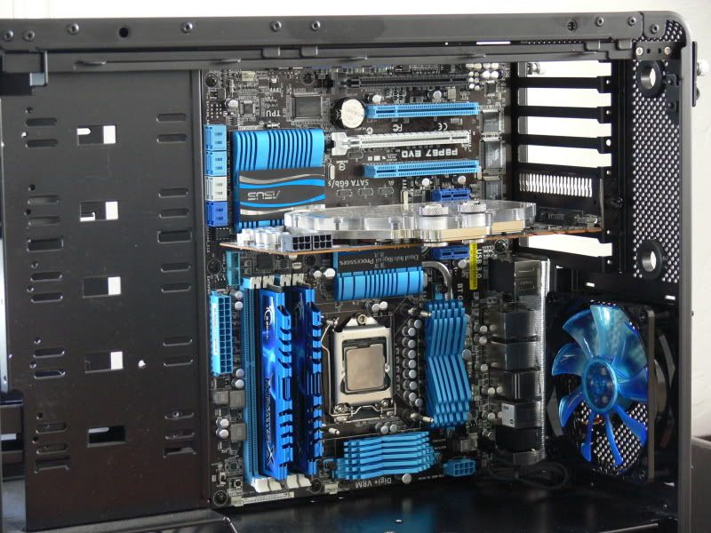

I started water cooling in May of 2010, since that time I saw many pictures of what proper water cooled rigs should look like [thanks to OCN and XS!]. My current rig is hideous to look and late last summer I went on a quest to start my own "dream" build which I plan to detail here.
The case. I fell in love with the Lian Li V1000 from the start, it had everything I was looking for in a case - brushed aluminum, reverse ATX, curved lines, no plastic and I really like the hole pattern design.
Here's what I have so far:

Yeah, it's powdercoated matte black. Sorry for all the dust, that will be gone before it's done.
I'd like to cover the midplate, should I go with acrylic or modder's mesh? Or leave it as is?

Thanks. I think you're right, should match the exterior.
