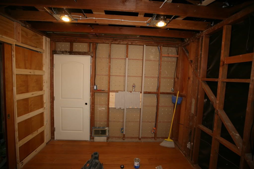

I decided to complete a major home office overhaul. This is a bedroom that is about 11 x 12 with a closet and 2 windows with decent views.
The walls had paneling placed over them and a standard sliding door closet where one door slides behind the other.
I want to fit two desks in the office with a small sofa and a TV.
A major part of the remodel is the closet, I will install two pocket doors in the closet so the doors will open and allow me to have a big screen and much of my electronics hiding.
This is an old house so I installed new lighting, a second electrical circuit, CAT 6 wiring, ETC.
IMG_0417.jpg?t=1302442151
IMG_0418.jpg?t=1302442237
IMG_0419.jpg?t=1302442276

I agree, since I only had 2 outlets and the old windows would not open I had to get things going. Those photos were on Friday, these are from Saturday. I will get the sheet rock going soon.
IMG_0420.jpg?t=1302495037
IMG_0421.jpg?t=1302495016

So I am making progress. I am using cabinet grade plywood for the pocket door walls even though I will paint them. It makes them more ridged and resist cracks from people leaning on them/ door opening into it. Cost $40 a sheet instead of $6 for sheet rock but not having to repair cracks will be worth it.
IMG_0422.jpg?t=1302663985
