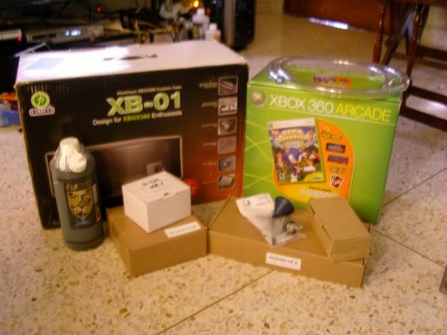

and here goes the pics:
all of my goodies

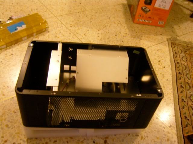

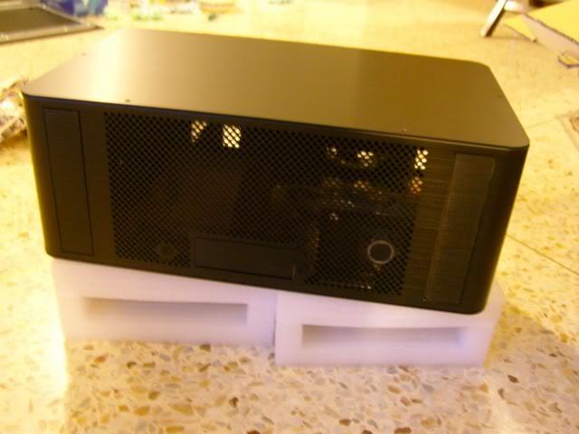

Lian Li XB01 case

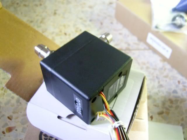

D-tek Db-1 pump

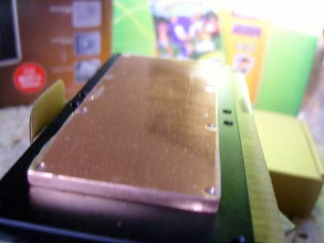

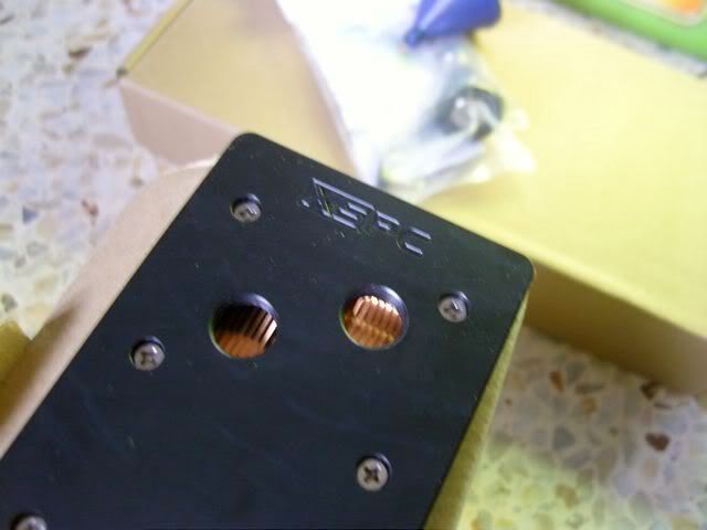

XSPC Xbox 360 WB

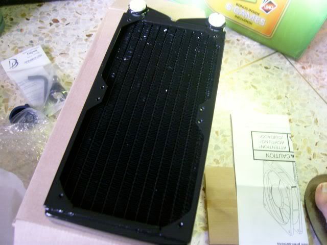

MCR220 rad

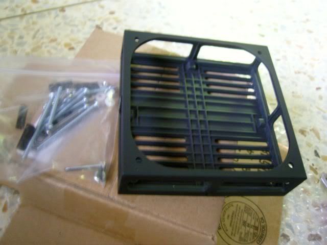

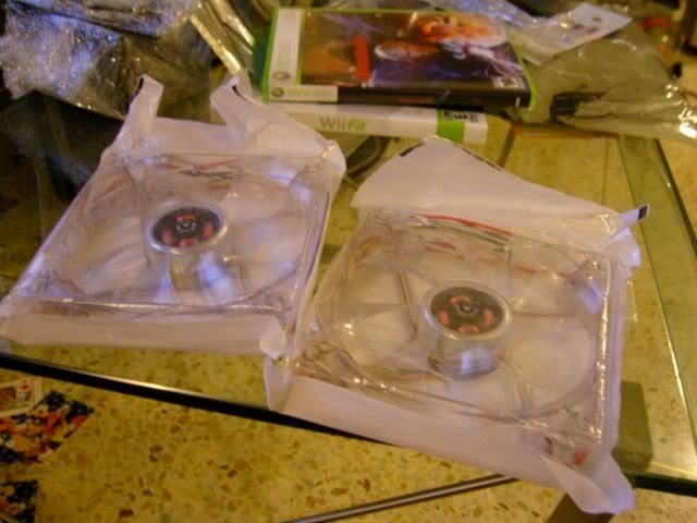

my fans
Rad box

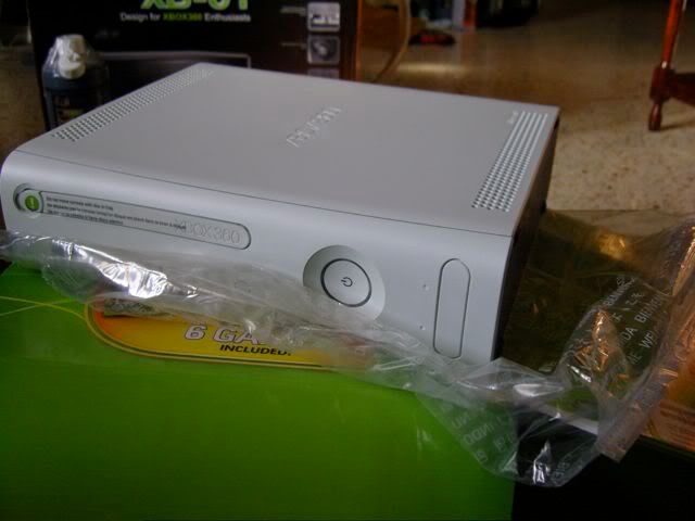

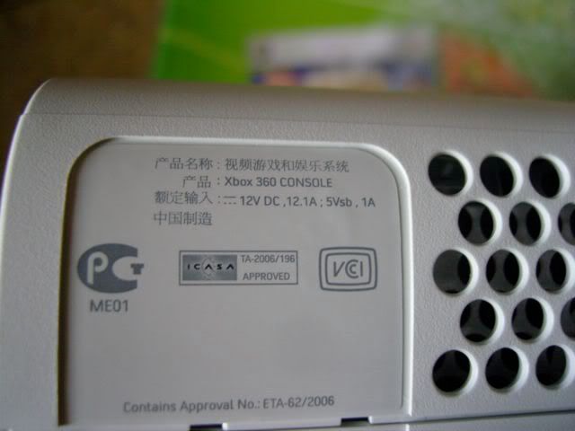

My new xbox 360
SWEET!! its a Jasper
unboxed

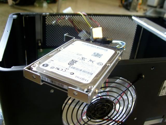

120GB Hard drive prepared for the lian li

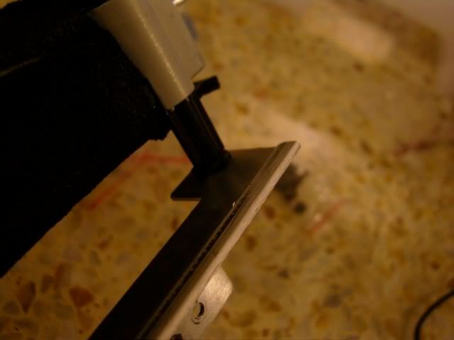

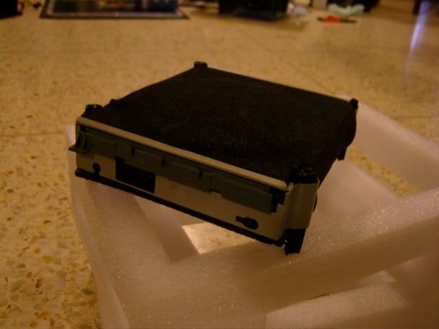

DVD drive silenced
vibration absorption material installed

installed rad box
RAD ready
holes drilled
pump installed
close up
view from the other side
prepped and ready
installed
its ready
the whole setup is ready and working
close-up on the rad installation
close-up on the pump area
overview of the whole system

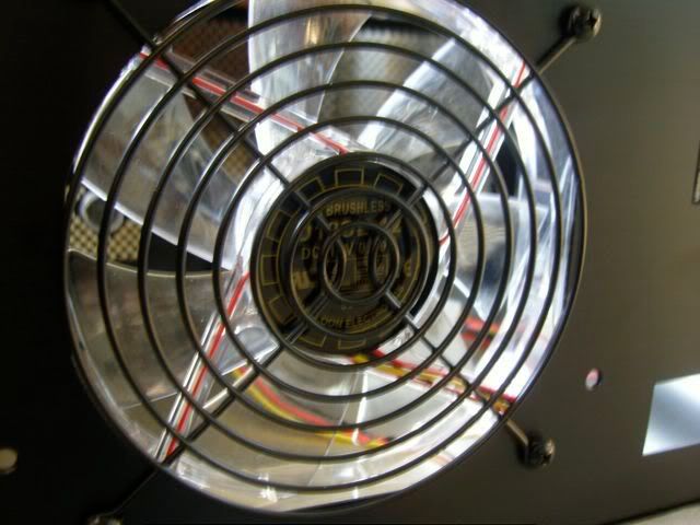

now I work on my Top panel
cut out my window
made my fan holes
installed my window and fan grills filters and fans
