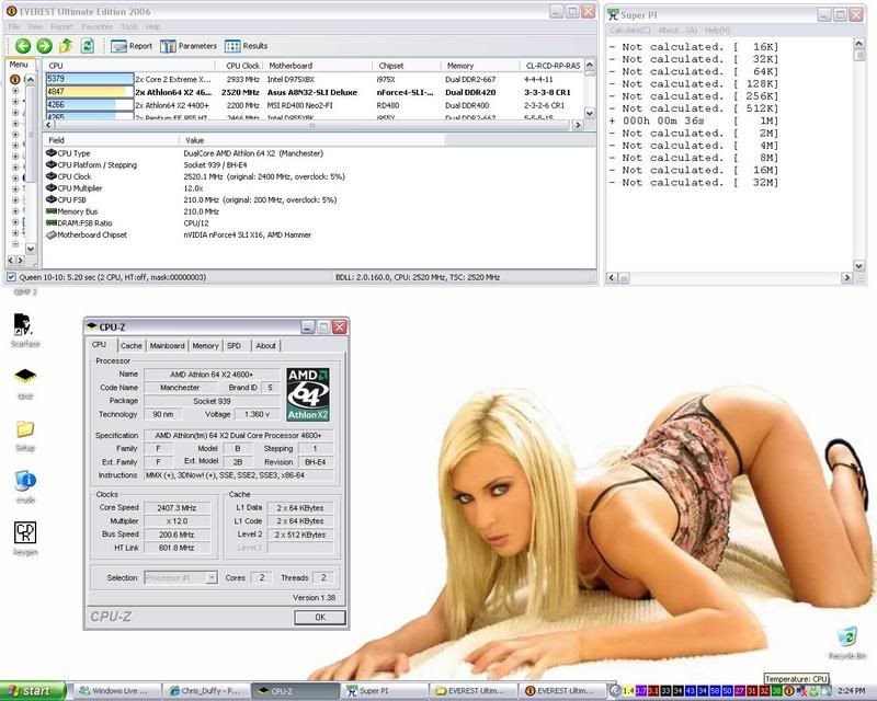

Well I tried but she's NOT gonna work
I ran the stock setup with AI NOW first off...jsut so see what it does. Which...is nothing. I went from 2401 to 2407MHz
Keep in mind im stock at 2.4
So I did the manual thing. Run my multiplier at 12x which is stock....couldnt get a stable OC. So I decided to go with the ever so awesome 9x miutiplier. Surely....I can BOOT with 2.5, 2.6, 2.7, 2.75, and 2.82GHz....BUT....Only if my ram in on 100MHz :S So even when I am there....it'll only read at 315MHz total .... That wont fly
So....I decided to do ONE last thing.....
Overclock the CPU to 2.8GHz. Done.
Booted into Windows. Done
Run CPUZ to check clock speed. Done
Run Orthos to prime it. Failed
Crappy thing is.... It failed in UNDER 15 seconds, and rebooted my computer on me
Im guessing.......crappy Stepping? Crappy whatever?

ok ok ok. i don't like asus motherboards but i'll help. try these settings.
CPU multi 9x
HTT 312
Memory Divider 133 (.67)
PCIE Clock 108 MHz
vcore 1.55v (keep on going up all the way to 1.6v if it fails, if it hits 1.6v and nothing happens, just drop it off)
northbridge voltage 1.65v
memory voltage 2.8v
see what happens.

Should I honestly tinker with the voltages? I mean this is BRAND new stuff dude. Under a month of use. Should I just run an OC of 2.6 for a lil while...break her in....then go to 2.7 and then raise the voltages.... er just pour it all on her

Okay to tweak your volt but just watch your CPU temps.

Well if you look on the screen shot...Im currently at 32 degrees
And these were "hot" chips. I redid the thermal paste, and used my thoughts on my fan placement with the "intake exhaust" and it's workin great

Alrighty. I booked off work early so Im here for the weekend. Here's what I did. I raised the FSB to 226 running at a 12x multiplier. Popped me at 2.7 and change. RAM divider is 133 which now goves me ever sho crappy DDR 301
The CPU is where I want it to be......RAM is blah
BTW....Voltages are not touched. I dont need to
