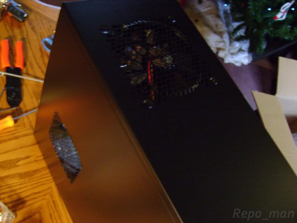

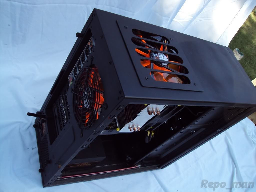

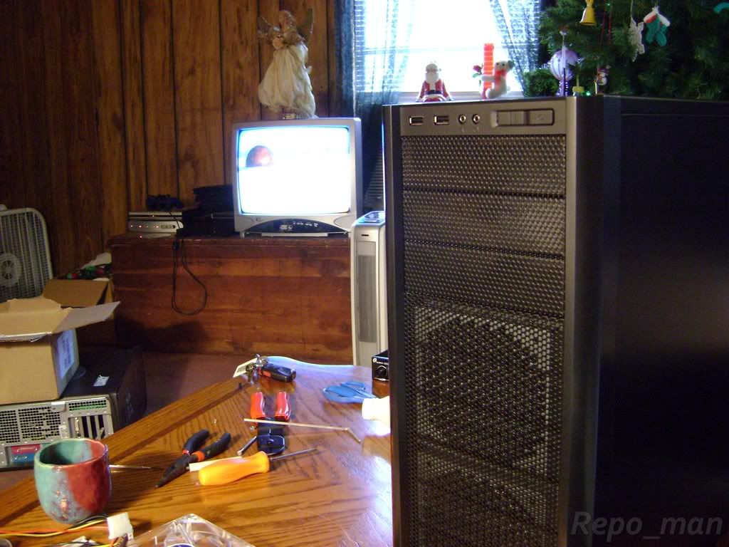

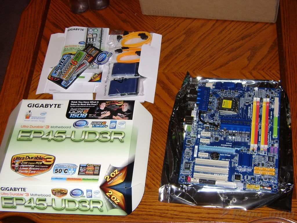

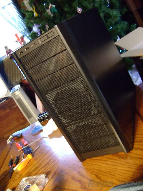

Update #1 - The case and motherboard arrive!
Well here is it, the starting foundation!
I'm really impressed this thing looks nice out of the box! I'm going to make it look a lot better though
Top 140mm fan
This silver has GOT to go

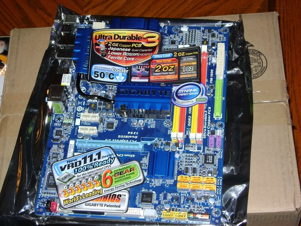

Mmmm UD3R, I've heard so many great things about this board, I am SO excited to see how it will push my e6750!

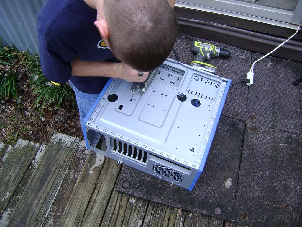

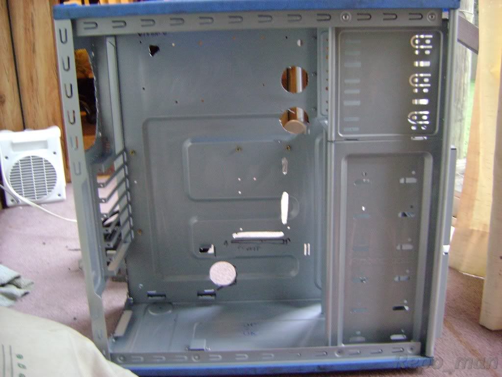

I couldn't wait to tear into this case. I need to build new hardware in it but I have to do cable management and paint first, so let the modding begin!
I've already got the cable holes cut and here I'm making a slot for the header wires.
Cutting the slot for the SATA cable.
Finished with the cable management holes!
I also removed the fan grills from the front and back 120mm's!

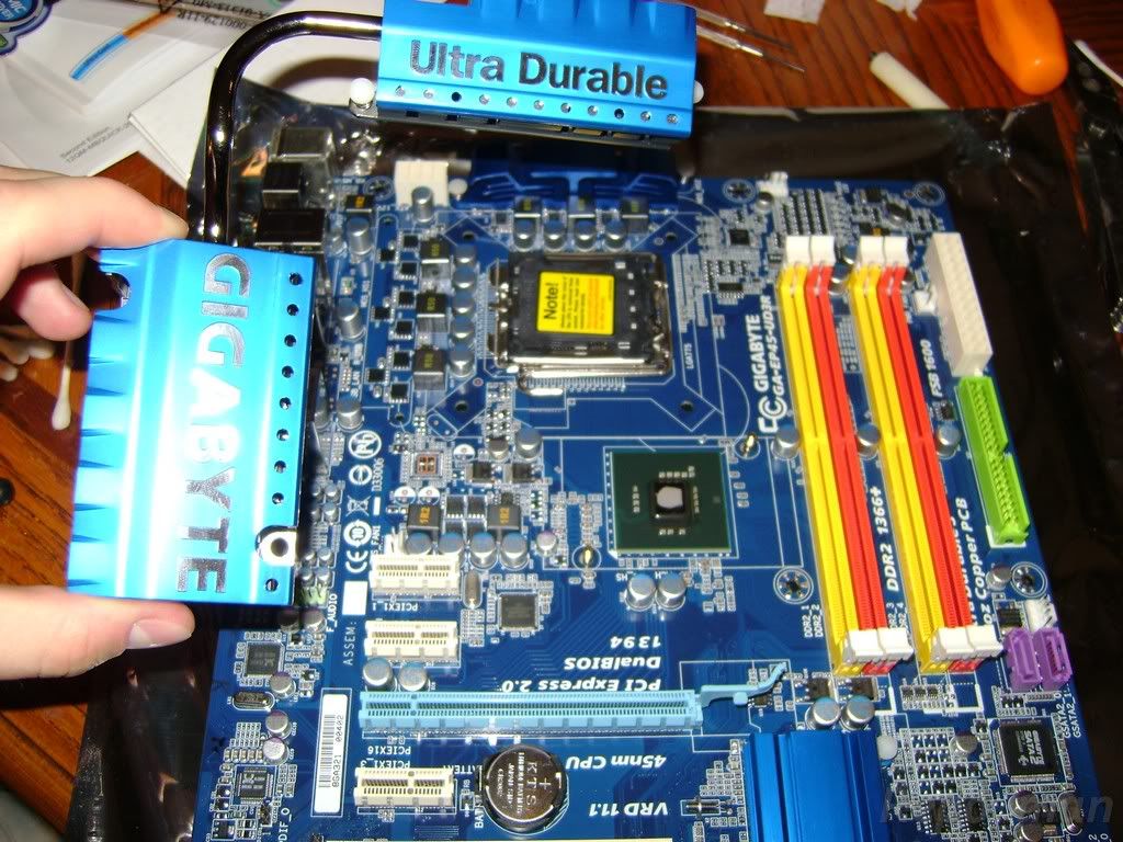

While benching the boards I found out the "Gigabyte" covers really restrict airflow in the NB and chipset coolers, so I took them off! I want the best performance possible on air, so off they went! They were just simply taped on and a little bit of force and a small flathead screwdriver took quick care of them.
Next I taped the motherboard tray behind the cpu socket so I could mark where I needed to cut.

Looking nice, now that PSU can breathe happily! I just used my jigsaw to zip out the cut, nothing really serious
Also used my jigsaw to cut the hole outward some. Now maybe the wires will fit,lol.
This is the cover for the fan on the TT Spirit NB cooler. It's originally copper, but I wanted to paint it metallic to accent the inside color on the motherboard. A few light coats and it was ready to go!
Man, doesn't that look awesome!
Very happy with how this came out!
Now I got the PSU in. The hole is a little off with how the PSU is offset in the A300, but it's functional and not that off. I'm happy with it!
Mm, sexy thumbscrew goodness!
And the best part, the wires fit now!

But now this grill has to go, to make room for -
This!!
This thing looks SWEET! This is the final touch I was waiting to put on this already nice looking case!
Side by side with a 120mm wire grill
I cut out the old grill and got the new one in place.
WOW! Talk about a drastic reformation, I am in love
