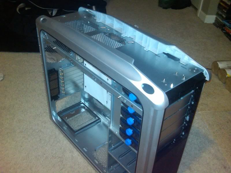

Ok so here are a few pictures of the case. I had seen the case a year ago or so and knew of the build quality. This thing is a tank, heavy, large, and well built, this is my main reason for choosing this case. First off, the cooling on this case sucks, its completely ridiculous. They have 1 slot for an intake fan and 3 exhaust fans, that makes no sense. But the good thing is that there is so much potential for modding this case that it doesn't matter how bad the stock version is, there are ways that it can be modded to become a GREAT case. I will update the modding plans i have for the fans and cutting to help airflow in the future. I only got a couple pics of the case because i know everyone has seen the pics of this case before.
BIG CASE... BIG BOX
Main Inside of Case
HD Bays In Case (The BIG cooling Problem)

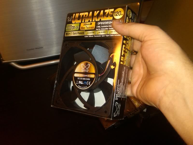

Ok so this was an easy chose. Only took about 2 hours of research to find out these were hands down the ones i wanted. The Ultra Kaze 3000. Yes they are loud but they make fan controllers! I have 7 of these that will be going into the case. 2 in front, 2 on the bottom, 2 on the top, and 1 in the rear. I will put pics of up the positioning of the fans as well as the way they will be hooked up to the fan controller.
MUCH bigger than i had pictured!
$85 of cooling POWER!

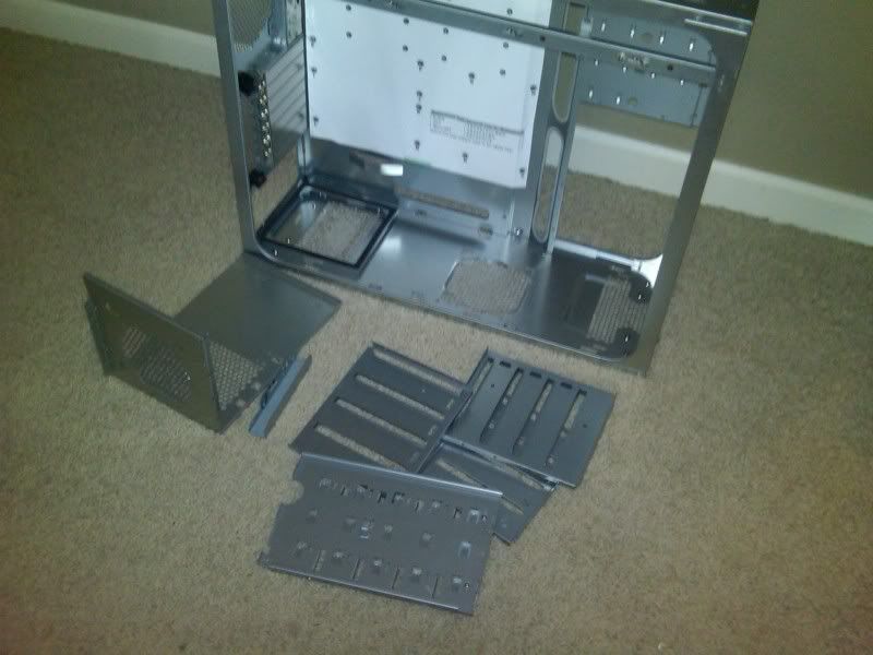

Ok so removing the accessories (fans, hd bays, useless crap) getting these wimpy fans out and readying the case for the Scythe bad boys that will be going in. Also removing the HD bays and the casing surrounding them for some cutting
Too much metal, these need some cutting...
Boy there is alot of stuff in this case

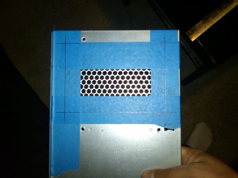

Ok, so today i was able to make the cuts over at my shop to the frame and HD bays. All cuts were made using a Dremel or 114mm Hole Saw. Had one problem in that i miscut slightly by about 1/16th inch one of the holes on the black exterior piece where the two holes are supposed to line of with the holes in the frame. This won't be seen though as its at the bottom of the case and my cat will probably be the only one to every notice this problem. I am probably going to be using a rubber piece between the fans and the case where the screws are for no vibration but i cannot find these at fry's, does anyone know something you can pick up at lowes or Home Depot that can adapt well for this purpose? Here are the pics!....
11
Ok here is the first marking for the Hard Drive Bay Cuts

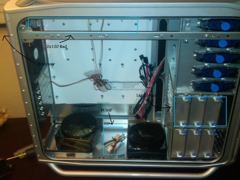

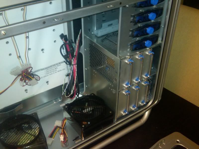

Ok so i got the 2 front fans mounted and everything turned out alright. I needed to mount them first in order to measure my distances for cutting the HD bay assembly so it will fit with the fans in there. I need some help tho... I am at a crossroads where i don't know what i should purchase next.
I don't want to buy any components that are going to become outdated until the very end (i.e. CPU, MB, GPU). I need a power supply, fan controller, and liquid cooling. I believe my best bet now would be getting all the liquid cooling supplies i will need in order to mount them and check for fitment while i am still in the cutting phase of this case. I have NEVER done a water cooled system before but here are my plans, some help would be tremendous:
1- 2x120 Rad up top. I don't want to cut a third hole up top unless really neccesary.
1- 1x120 Rad in the upper HD bay slot.
My question is what is my best bet for cooling? Obviously the CPU will need cooling, as i am going for over 4Ghz on a AMD Quad Core. But would it be good to have the second 120 loop go to cool the GPU? Or for the Northbride or something else? Any help would be great as i am a real Noob when it comes to watercooling. Thanks,
Ok Here is the plan for a water cooling setup, will this be enough and sufficent for what i want to cool or what? Suggestions are appreciated!
