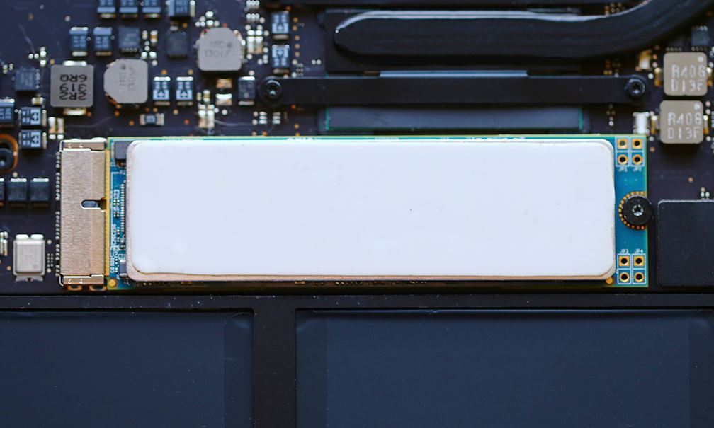

Right! I guess that particular pad is designed to transfer the heat to MBA chassis
820 Posts
Originally Posted by The SSD Review
"... a rather prominent non-removable heat sink that sticks to the base of your Mac Book Air, once installed."
As the Macbook's shell is made of aluminum, that's a nice solution that basically turns the laptop's case into a large efficient heatsink for the SSD.
288 Posts
Yes with alu simple thermal pads will do the trick, unfortunately plastic is pain when comes to heat transfer. It's much better at storing heat than transferring it.
