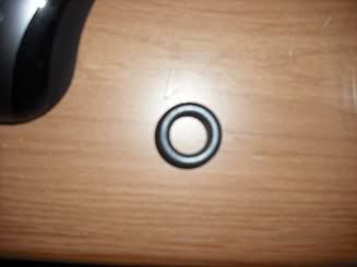

Is this the thing you're talking about?
because other than the mobo and a few assorted cables, that was all that was in the box.
Nope... the speaker looks more like a flat topped mushroom... it was in the bag with the screws and standoffs.. I'm not sure what you took a picture of.
