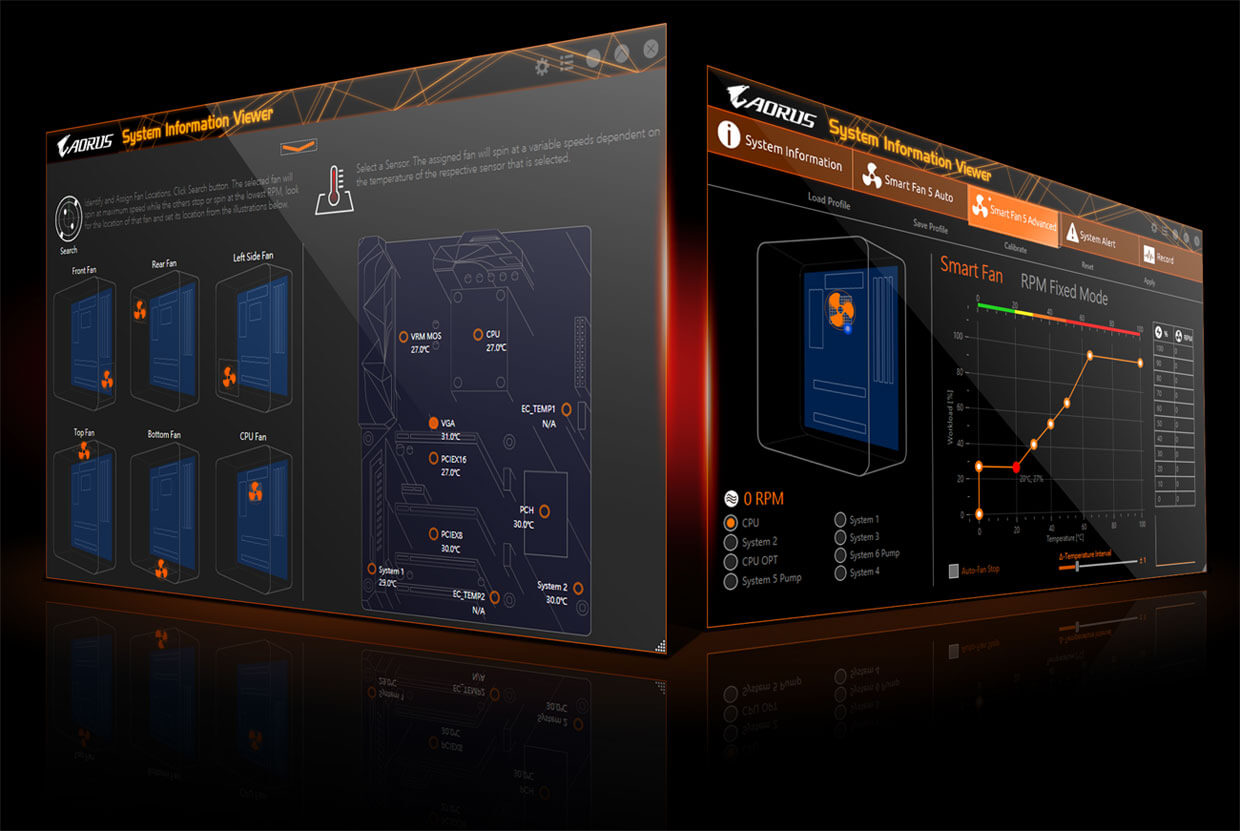

Finally have a set of fan curves im happy with.
Idle - 31-39c
Opening a Program - Boosts to 49-51c
General Browsing - 40-50c
Took a few days to get there but here we are. Saved screenshots of these too for future reference!
mmmm you have all your fans set to cpu meaning they will all ramp up when the cpu gets hotter, I did not do that, but set my case fans to system 1 so the fans never ramp up and my case does not get that much hotter when the cpu is at full load.
100 Posts
Idle - 31-39c
Yeah I get that but they're not aggressive ramps (Until temps get over 60c, and it's rare they do!) and the idea is to bring a bit more cool air in and get the warmer air out.
Based on this image, System 1 is bottom left corner which seems a pointless place to measure as in theory, that area will never get that warm.
https://www.gigabyte.com/FileUpload/Global/KeyFeature/1194/images/smartfan5-software.jpg
