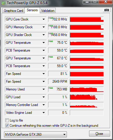

This is what its doing:
Just got done playing for 30 minutes and this is what i got. It was the third level. I think this only happens on certain levels? Because it ran just fine, a smooth 30-45 fps all Very High 2X AA @ 1400x900. Gpu load was 99%. I did defrag and disable the paging file. I think it's just certain levels though... Also changed my system ram from 8-8-8-24-2T to 8-8-8-24-1T (Stock is 9-9-9-24-2T)

All the symptoms point to it overheating. Try other software to monitor the temp and see what it says.
Edit - It would have to be significantly downclocking itself for performance to get that bad.

I noticed Precision does throttle down my card when im just on the desktop. Yeah your right it sets the core to 302, shaders to 608 and memory to 600. But when i run crysis and it happens i go back and check Precision and it says the card remained at the right speeds, no decrease. But i will uninstall it tonight and see if that fixes it
EDIT: It would go to 2-5 fps stuttering badly even if i didnt alt-tab at all after about 15-20 minutes.
