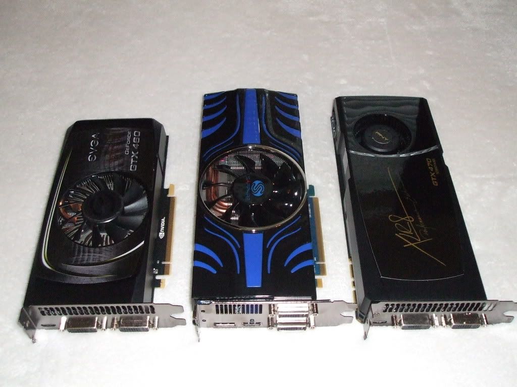

It've been more than two months since nvidia released GeForce GTX 460 videcards and competition between ati and nvidia got noticably hotter, and guess what its great for us - consumers. Personally at the moment of gtx 460 release i was using Sapphire ati 5850 Toxic on my primary pc, but i was very curious how close gtx 460 can get to 5850 and to its bigger brother GTX 470, so i decided to test them all and to make this mini review to possibly help those who can not decide between these great cards.
So here they are: EVGA GTX 460 (768 mb) vs PNY GTX 470 vs Sapphire Radeon HD 5850 Toxic:
Sapphire 5850 Toxic comes factory overclocked @ 765/1125mhz instead of reference 725/1000mhz. Both Evga GTX 460 and PNY GTX 470 are reference design, running at 720/1440/1800 and 607/1214/1675mhz respectively. Ive decided go for 768Mb version of gtx 460 over 1Gb version because of its price - its $169 after nvidia surprised everyone with the price drop, and cause its potentially a great overclocker.
My test system is in my signature, its an overclocked to 4.0Ghz i3 540 and 4 gb of Wintec Ampx 1333 ddr3, which is more than enough to avoid any bottlenecks for the videocards.
I am using Catalyst 10.9 for the Radeon and Nvidia 258.96 drivers. OS is Windows 7 x64 Home Basic. All benchmarks performed at 1900x1200 resolution. Cards were tested stock and overclocked. I ran these titles:

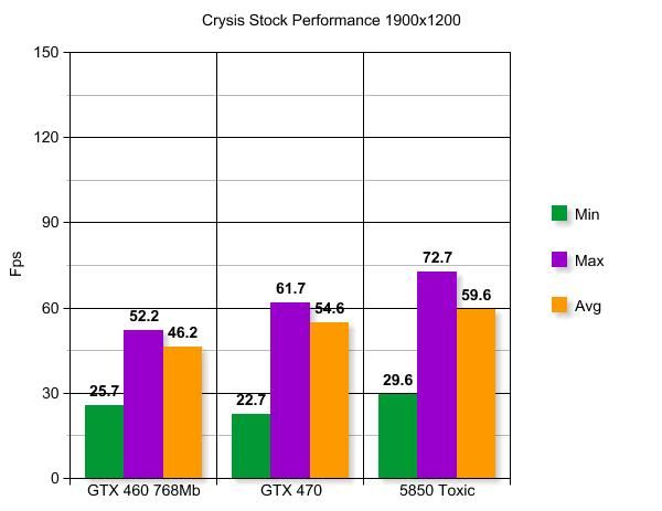

Crysis:
Settings: everything High, noAA, no vsync

HD 5850 rapes the GTX470 and still keeps up with that poor overclock on the core.
1,149 Posts
I was a bit surprised how good it performes comparing to gtx 470 myself, and yes u r right this particular 5850 isnt the best overclocker, everything above 805Mhz on the core would give me errors. I have tested stability with OCCT for 1Hr.
