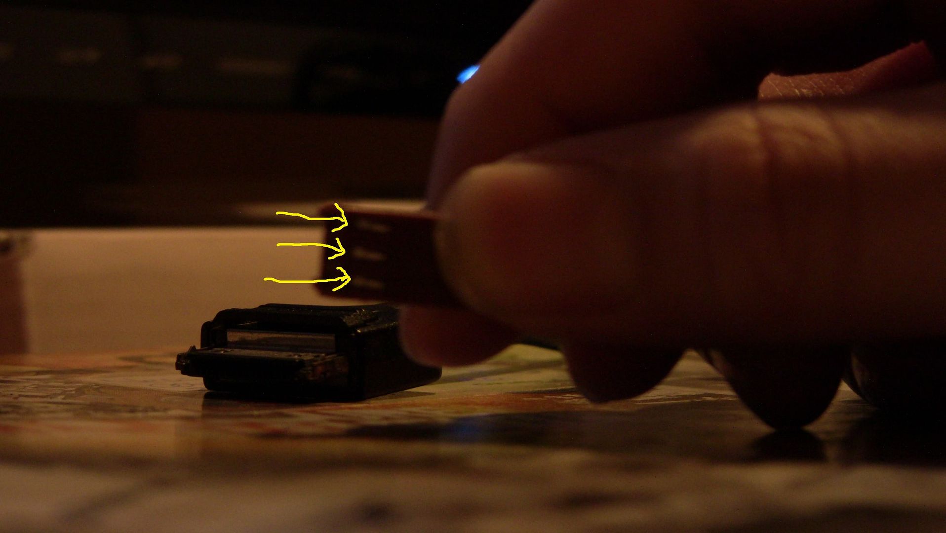

thought of sharing how to make this and let to see my finished product.
1. Get an ac adapter under 12v i used an old Motorola phone charger. How lesser volt how lesser sound, but do note lower voltage means lower CFM.
2. Get a fan splitter cable(to let it look professional and u can have more fans on a single adapter) and take the pins out it. the yellow one is not necessarily and i say dont try it!!! even your ac adapter has it
piccy
3. rip off the head of the ac adapter and try to search the black an red one
4. rip the black and red cable and try to get those metal threads of the ac adapter
4.5. Use a multimeter how much it really Volts it gives.!
5. you see metal pins on your splitter cable after removing the pins photo how it need to look like :
I do not recommend to do yellow one .You need to bring the red with red and black with black.Wrap some over each on red and red wrap tape black and black wrap tape and then wrap once again
5.5 You could solder it but binding them together is fine
I just bound them together but soldering it is more sturdy.
6. viola you have a working ac fan adapter
7. how more "Amperage" how more fans, voltage is not a matter cause it only says how hard your fan will blow.
finished product piccy's :
dont try to go over the amount of A
and this was only a example most fan worn spin up at 4.4V but my san aces does
try to go 5+V
