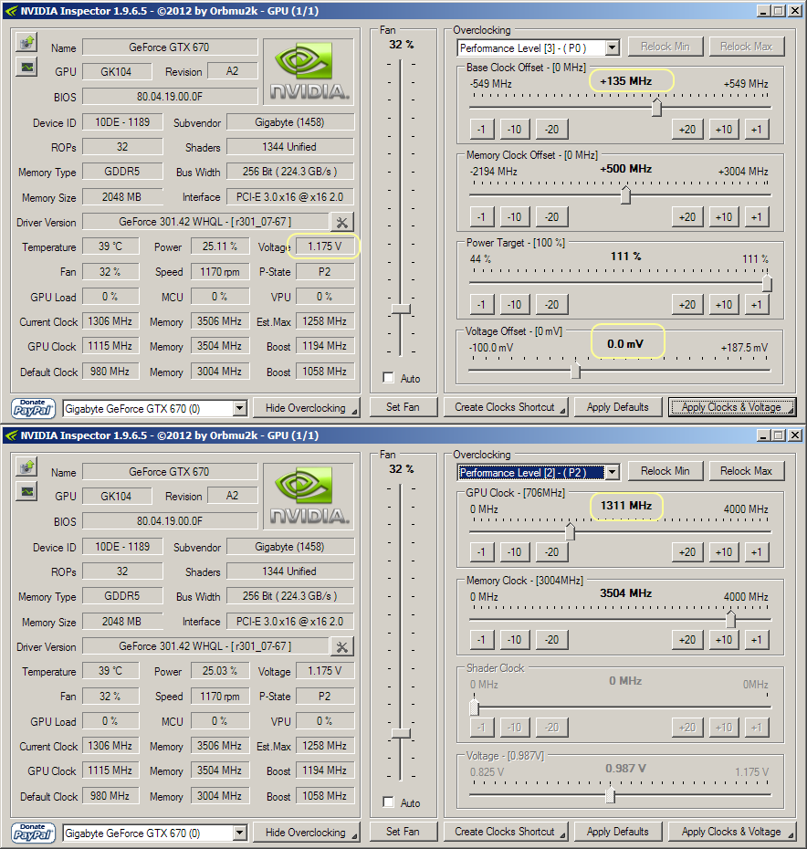

Setting a fixed overclock
First, find your maximum boost/memory offsets using the normal overclocking methods.
I'm going to apply a +135/+500 overclock which equals 1311mhz/3500mhz. Use your own values in place for the instructions below.
1. Force P2 mode using "nvidiaInspector.exe -forcepstate:0,2".
2. Open Nvidia Inspector and go to the P2 dropdown entry. It should look like this:
3. Click unlock Max and move the GPU clock to 1311mhz. You can try and move the Memory Clock but it simply bounces back. Hit Apply Clocks. Notice how the Current Clock on left is not the value you just set. If you do the math, it is exactly 135 below our target.
4. The P2 mode still relies on your P0 boost setting to determine max clock speed. So, open that drop down and set your values. Once you click Apply it will now look like this:

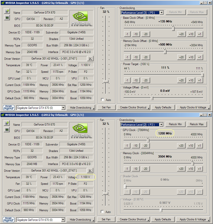

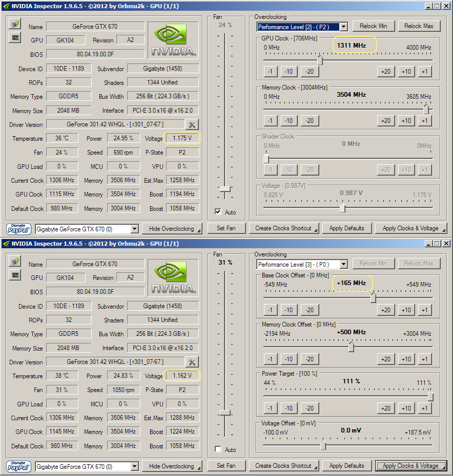

Undervolting
To undervolt requires a bit of trickery. The voltage is calculated by your current clock speeds distance from your boost clock speed. Increasing your boost value or decreasing the P2 clock speed will adjust your voltage.
Normal overclock with stock voltage
Decrease P2 clock speed and voltage is automatically lowered - this is Heaven stable for me
Increasing boost decreases voltage at selected clock speed
