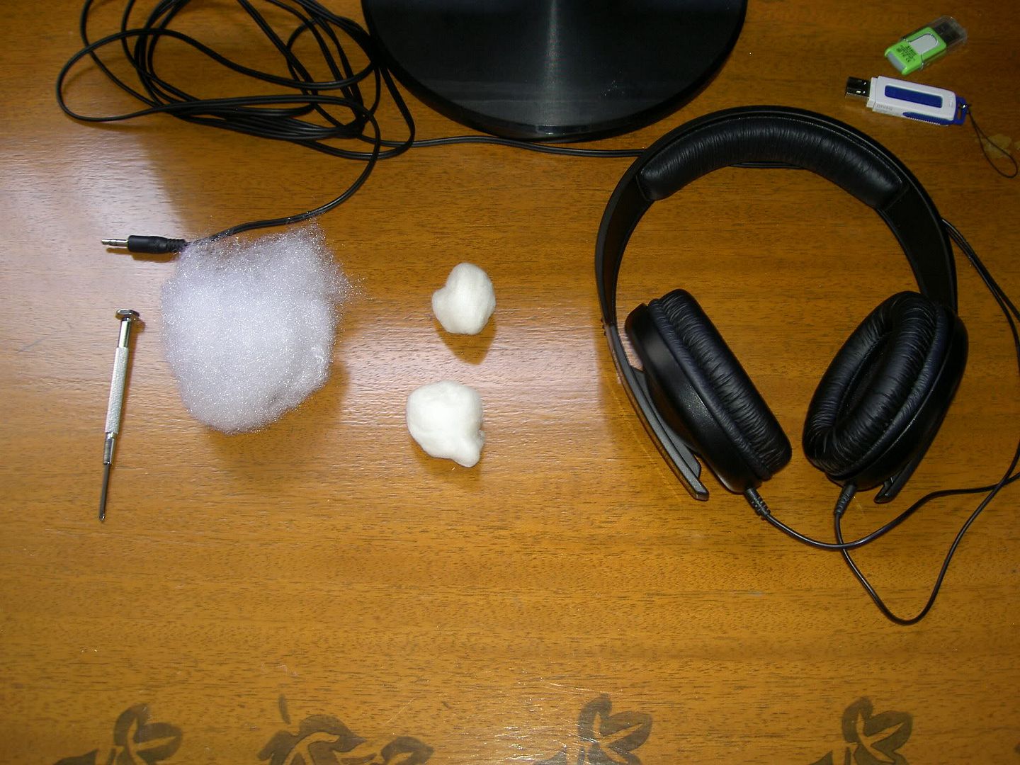

What you'll need:
-2 cotton balls
-A small handful of Polyfil (Polyfil works best, for me it worked better than the polyesther stuff that comes in sheets)
-A small philips screwdriver
You can get Polyfil for really cheap at craft stores. I got a 12oz bag for like $3.

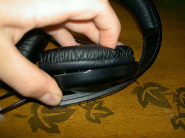

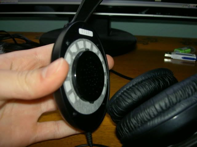

First, pry the pad off the earcups. The pad is attached to a plastic piece that snaps off.
Pad removed. The plastic piece the pad is on snaps on around the circle in the center of the earcup. If you are having trouble getting the pad off, you can put your thumb in the center, near the edge of the circle, and pull the pad away with your fingers while pressing with your thumb to separate the two pieces.

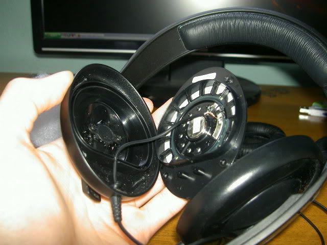

Now take out the four screws holding the ear cup together. I had already removed them in the picture.
Sorry for the blurryness, it was nearly impossible to take that picture without it
Next, pull the baffle piece off the earcup.

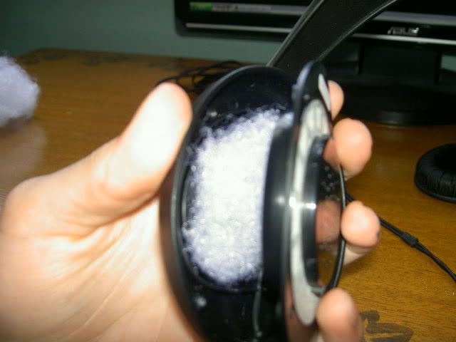

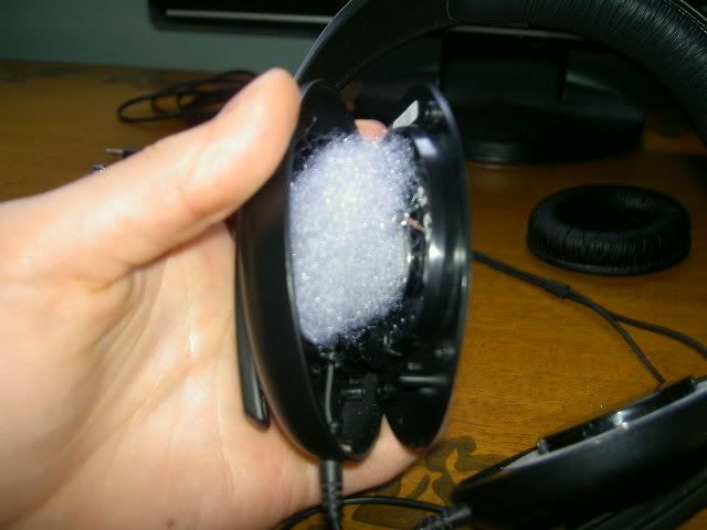

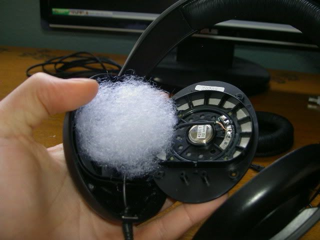

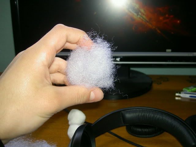

Take two chunks of Polyfil about like this, make sure they are the same size, one for each ear cup.

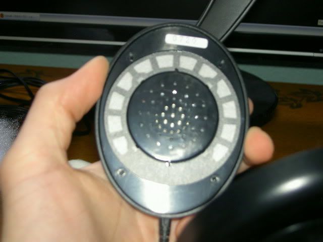

and stick it in the place behind the driver. It should be about this big.
It shouldn't have to be compressed more than a little when you put the baffle piece back on.
Close the earcup. Make sure to get all the Polyfil inside the center section, so it doesn't stop the ear cup from closing all the way. Make sure the cable is in the slot for it.

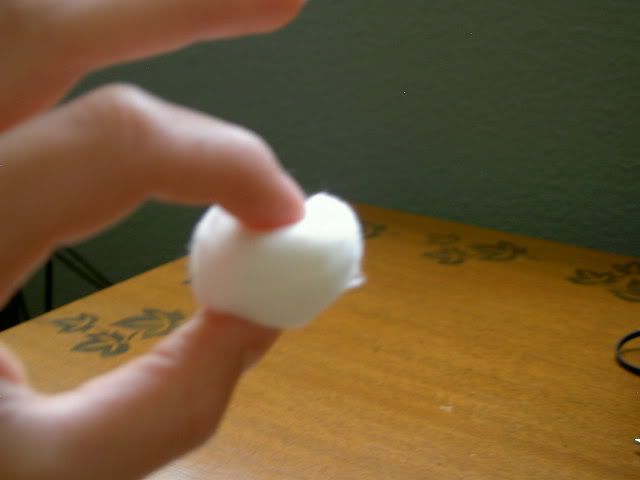

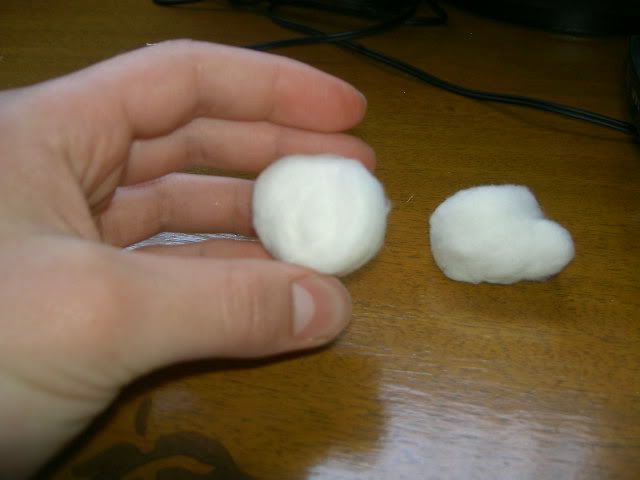

Now take the cotton balls,

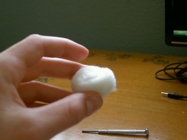

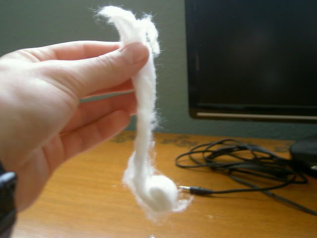

You can see how there is a grain, where it was rolled up. Like a cinnamon roll
Grab it in the center, with your thumb and index finger gripping the center area from the top and bottom, with the grain facing up.

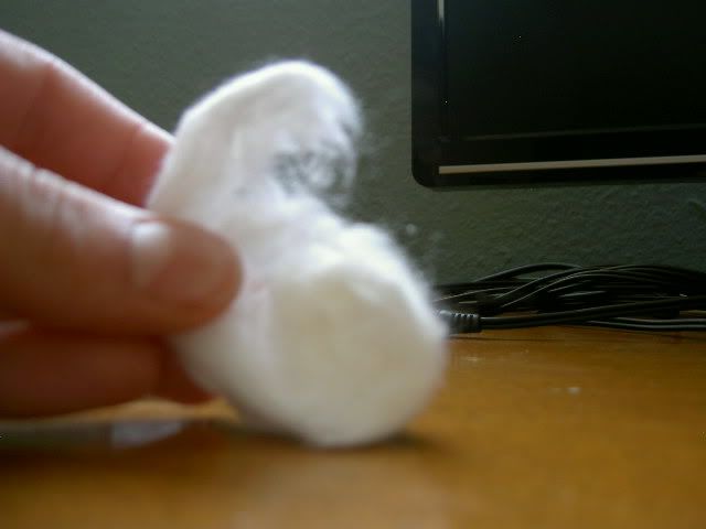

Then grab it in the center with the other hand as well in the same place. Gently pull out so it starts to separate naturally.
Pull on it some more, you should be able to feel where there is naturally a grain. You may have to tear through a little piece, but after that you can just unroll it the rest of the way.
Unrolled most of the way.

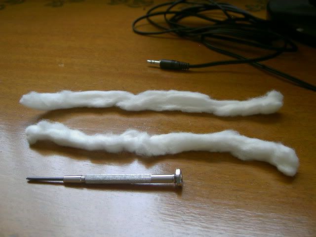

Do this with both, you should end up with two pieces looking like this
They should be around 4-5" long, it doesn't matter too much.

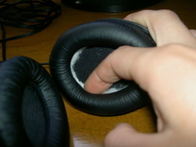

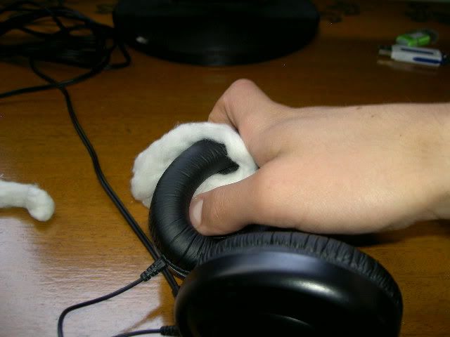

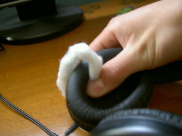

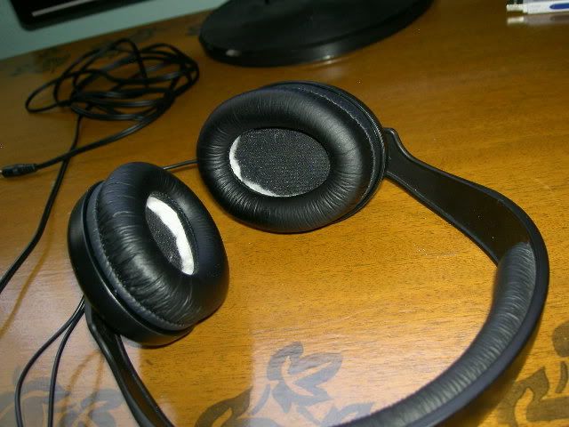

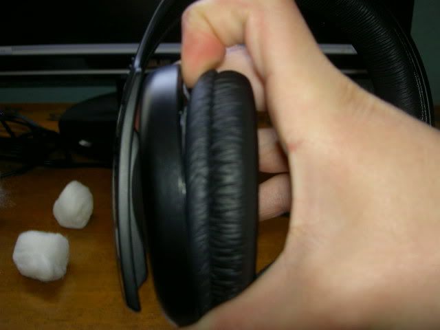

Now take one and stick it somewhere under the pad on your HD202, I like to start at the bottom just to get it more even.

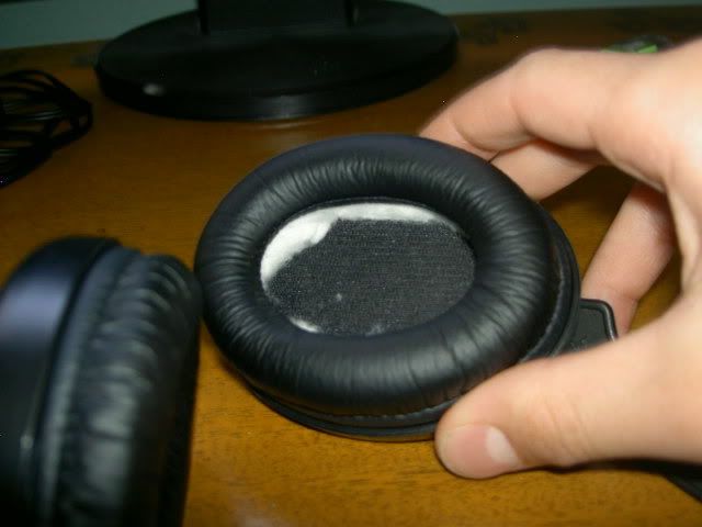

Stuff the cotton strip under the pad, working your way around the whole ear cup. You should meet up at where you started with relatively no excess. If you have some left over just spread it out, and shove it under the pad farther.
It should look like this.
Now go around again and push it in with your finger, and make sure it is even, and under the pad all the way.
Repeat with both sides, and you're done!
Now they should fit over your ears more easily, and take some strain off your outer ears.
