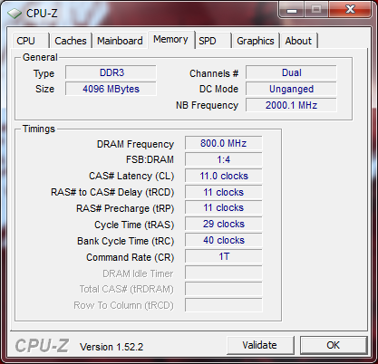

lol man i feel stupid, thanks your right. ok but one thing its not running at the rated timings and latency how do i fix that?

This is what I see on CPU-Z
Use the SPD tab in CPU-Z to decipher which settings on above screen to input.
Start out by finding the specs on your RAM, set it to stock configuration for timing and voltage, then you can play with it from there to find its limitations.

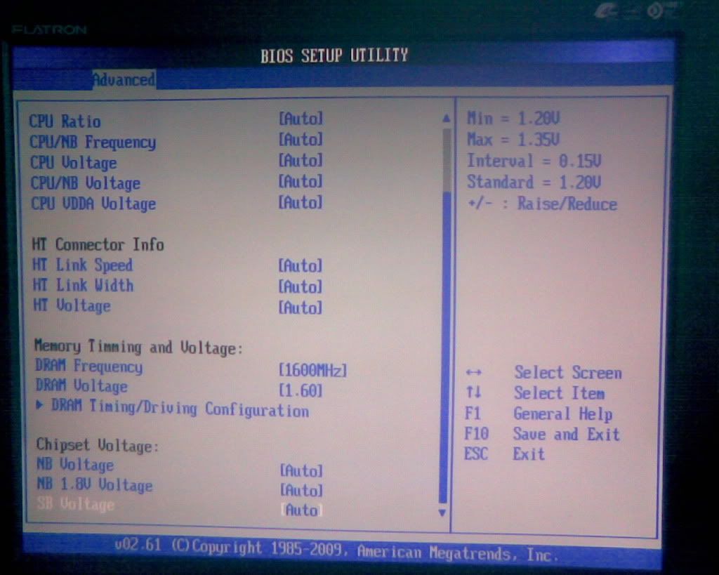

This is what I see in my bios looks different then the settings mentioned above. Any ideas on what I can do?
Thanks.
GAH took pic of bottom half! on the second pic brb 20mins will reupload.
Leave DRAM Frequency and DRAM Voltage as they are on that upper pic.
On the second picture, chance TCL to 7, TRCD to 8, TRP to 7, TRAS to 24 and TRC to 40. Also chance DRAM Command Rate to 2T. Raise voltage little if wont work (1.7v?).
What mobo you have?
It works thanks guys I got it running on rated speeds. man that feels good.
