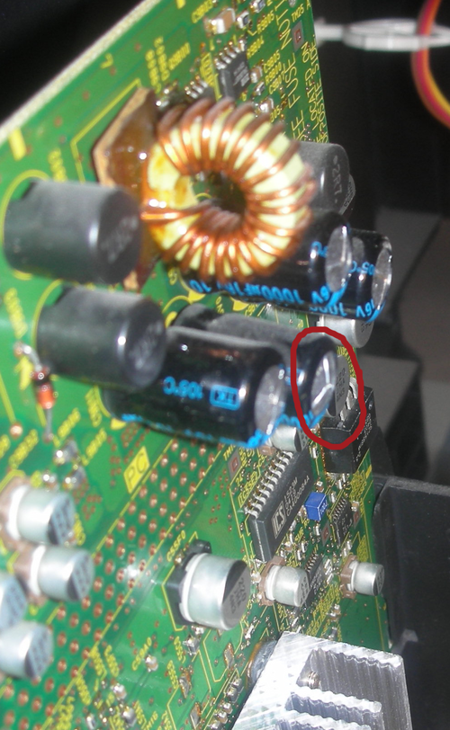

I've never soldered anything but I'm pretty confident with a little coaching I can pull this off. I was just hoping you guys can give me some pointers. This fix is for an older projection t.v.
Attachment 87106
I would be replacing 4 of these capi's.
edit: Turns out its pretty hard if its your first time... but it is definitely not impossible. The more you work with solder the better you can control it.

Thanks for the tips everybody. I'm currently trying to pull the board out (the pic above I found online) I'm trying to check if it is indeed these capacitors. They are supposed to be bulging from what I hear.

Can I get confirmation that the bottom cap is bulging out a little?
Can't really tell but if it looks bulging, it is. It should actually be sitting a little recessed around the casing.
Thanks for all the help again guys... Rep + to all you guys. One more thing though. The guide I'm following says that I can use 1000uf 35v or 25v caps. However, the ones currently on the board are only 16v. Will having a higher voltage be better? Can I even do that?
Ah, and last. How do I remove the ones that are currently on the board?

Yeah, you have at least 2 bad caps allright.
Remember, only replace them with caps of higher voltage/capacitance.
NOT LOWER.
In the case of the mobo though, try to get as close a match where capacitance is concerned.

Update here... the operation was a success. After practicing with a couple old sound cards other old equipment I decided to take the plunge. The operation took 4 hours from beginning to end. This included removing 4 caps and replacing all of them with brand new ones. I have a new found admiration for techs who solder on a daily/weekly basis. It seriously requires a steady hand and a deep understanding with the materials that you have to work with.

Yeah it worked great. It could probably be better but for a first timer it wasn't bad at all. TV works again. Its a 65inch Projection HDTV and it would have been a shame to leave it as it was. I would show you pictures of the board but I already put it back into the TV and sealed it up (can't wait for my dad to get home *saved him a couple hundred bucks*).
