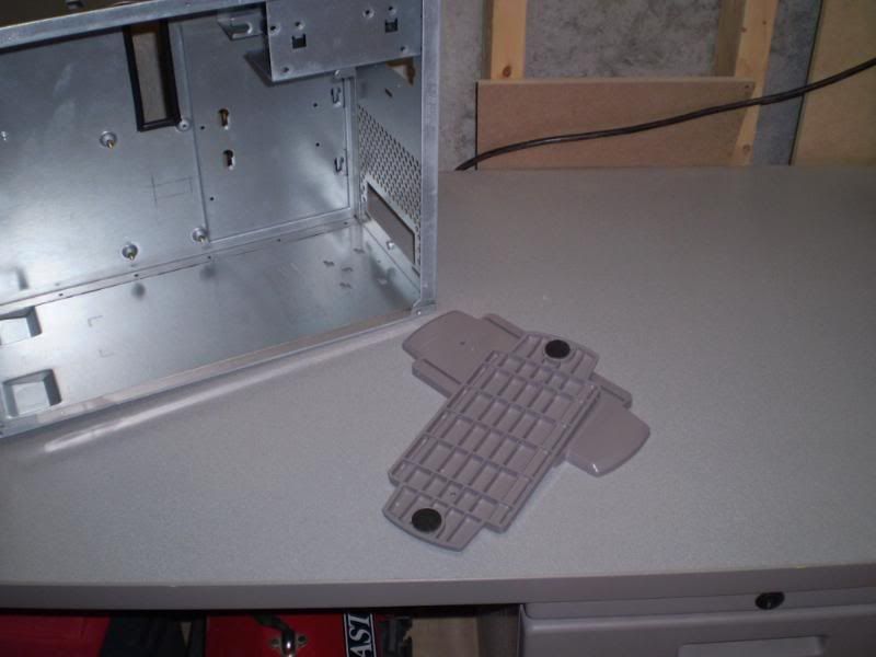

I'll be using a case which I have already begun to mod. The chassis is from an old Pentium II Compaq Presario. I pulled the case feet off of a decade old computer my neighbor was about to take to the dump. Most likely, your case feet will look something like this, but that doesn't change the mod much.
Decide exactly where you want your feet to go:
I decided I wanted my feet flush with the back of the case, so I adjusted accordingly. But those rubber feet are going to have to come off. They look like they might make good spacers which may help to further lift the case.
