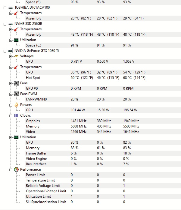

OK whats funny now,im playing cod,i have temporary 1080p monitor so it does not hit 100%,i will get 2k soon again and it will hit 100%
Look,no throttle,volts 1+,core speed - super
under load,max 0.8,throttles,***?

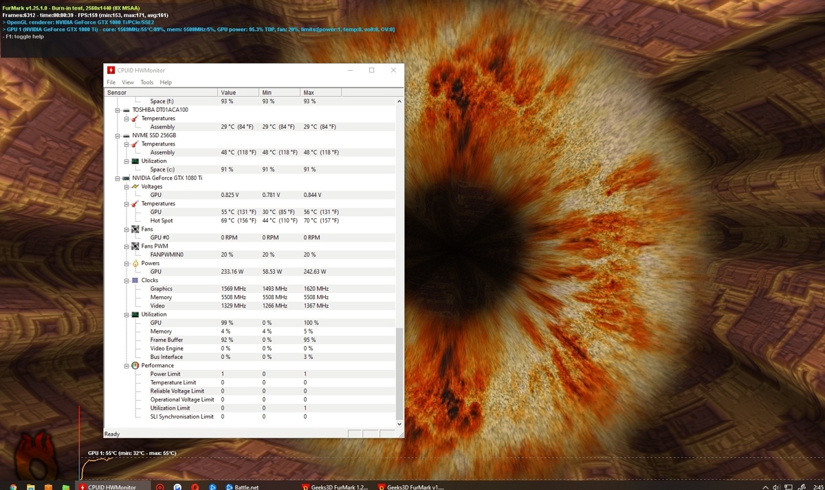

NOW llook,u ran furmark
it wont go more than 0.8 even tho it hits 100% load,*** IS THIS CARD DOING??? and on 80% load it works perfect.

It's not funny at all. It's logical: 1080p is significantly less load on the card so of course it's going to not run as hard. At 1080p it's not likely for the card to be hitting power limits and throttling and all of that because it's not that much of a load for the card. However 2K is twice the load vs 1080p and you're likely always going to be at 100% load on a 1080 Ti in every game trying to run 2K on this card no matter what. And of course 2K is going to cause the card to hit power limits and start throttling and all of that due to the higher load placed on the card.
It won't go to full voltage in furmark because the nvidia driver detects furmark as a "Power Virus". The nvidia driver will not allow any nvidia card to run at 100% when in furmark because furmark was literally frying / killing cards years ago so nvidia actively took steps to prevent cards from being maxed out in furmark. Do not use furmark to load test your video card. Use 3dmark instead.

Since I dont have other monitor i realised there is settings in call of duty where you can upscale graphics as much as you want,so whats what i did to test.
Anyone knows how to get rid of "we have detected fan ..... " thing? Since I disconnected fans. My gpu hot pretty hot btw ~.~ Need to raise radiator coolers speed and maybe even waterblock
because i guess they spin now just on some random speed.FUNNY THING? NO POWER LIMITS WITH MY DIY COOLING LOL EVEN THO IM FRYING.
