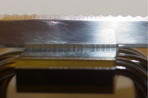

6) Can I order a pre-lapped TRUE? I'm not going to spend time lapping it myself.

add the fan u want,bracket, and get it lapped

I don't know how much CrazyPC charge for lapping, but what you don't get to see is how flat the base is out of the factory. I bought the TRUE Black and a HR-05 SLI NB Cooler and when they arrived the base of the TRUE was fantastic. I'm just going to use a high sandpaper to 'buff' up the base a bit.
