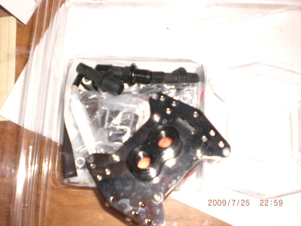

That is an apogee GT (with all the fittings) and some koolance 7950GT coolers. (Well, one's for an ati card.)
The Koolance cards.
GT and its accessories.
This is gonna be great to cool the hardware in my Peavey mod. That's a 939 socket and the EVGA 7950GT. I'm thinking I'll hack up the remaining koolance block for use as a NB cooler.
The ApogeeGT comes with a variety of fitting sizes, and slickwilly provided some vinyl tubing in the 3/8 and 1/2 varieties. The Koolances can only take 1/4, and my local ace is out of it until wednesday.
What I'm thinking I should do, and would like some input on, is the use of mixed sizes of tubing in a loop, and thoughts on manifold usage.
I'm thinking that I could create a simple manifold out of a capped tube and 2 1/4 fittings (Koolance as GPU and NB coolers) and one 3/8 or 1/2 for the apogee gt.
Would there be any problems with going Pump -> Rad (bong)-> Manifold -> 3 blocks - 3 returns to Res - Pump?
