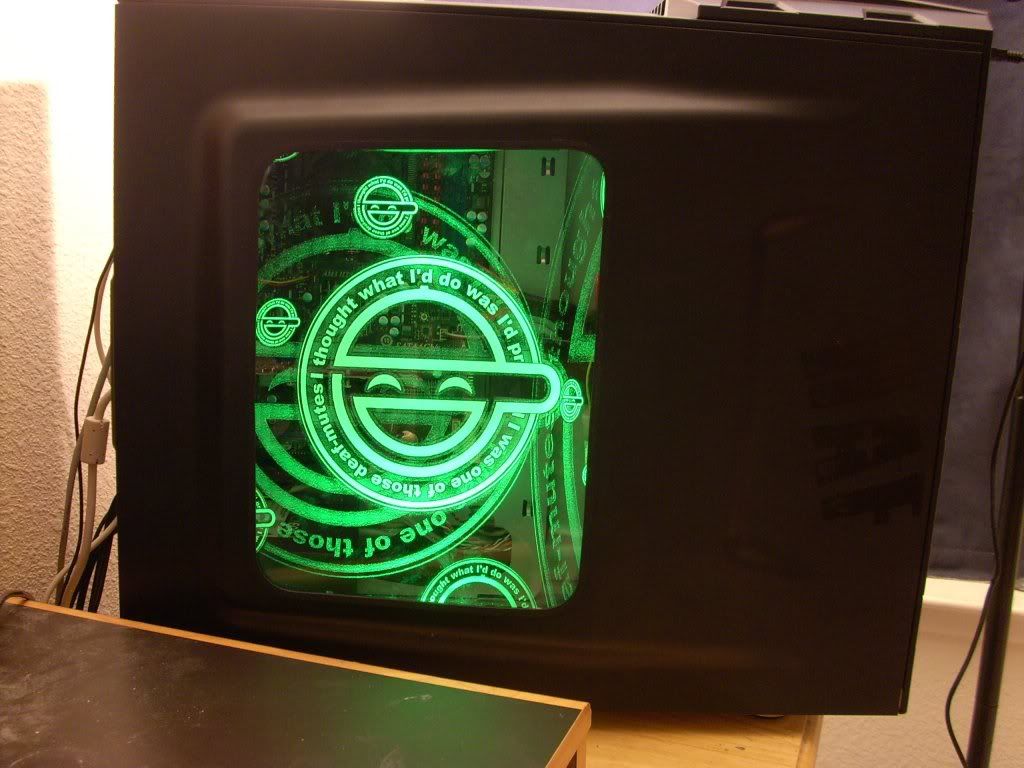

As far as the window you can use 1/8" acrylic. It comes in many colors, its readily avaiable from hardware stores and is easy to work with. You can also do things like this.
Kewl window! If I get a window I will look into doing something like that.
