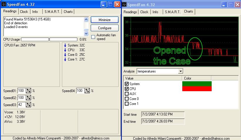

I opened my case today and saw my cpu and system temps drop a good 2-3C. This indicates poor air circulation or not enough incoming (cool) air, right?
Here's the chart with no test/graphics:
Here's what I normally run idle with the system closed:
Should I add a 120mm fan on the side blowing at my Zalman heatsink?
Thanks in advance,
Paul

I turned all fans to exhaust, and my temps rose a bit.
System up 2C to 36C.
CPU up 6C to 43C idle.
I removed the side overnight and was surprised to see that my cpu was at 28C and my system temp read 29C. Yup--the Zalman CNPS7000A-Cu was cooling the CPU better than the system (north bridge?) heatsink (passive) was performing IDLE.
I fully believe, now, that if I install a beefy 120mm fan on the side door, directly on top of the CPU, that the Zalman will have enough fresh air to cool the entire system at least as well as "open case."
Thoughts?
-paul

I've already been through the Orthos / TAT tests. Just ran it again, based on your recommendation.
Case off, Orthos (cpu test), after 30m:
CPU: 61
Sys: 35
After that, I put the case back together (all fans exhaust). 5 minutes later, temps read:
CPU: 71
Sys: 33
I believe that my CPU h/s is starved for air with all exhaust. I also believe that a 120mm fan on the side blowing IN (with all others exhausting) will cool the case better than the front two (120, 80mm) blowing in.
-Paul

I did it as a test, to see if I could pull the hot air out. No dice. Running open case now and temps never exceed 61C on the CPU (now running at 3.1 GHz). I am convinced now that I need a side fan--wish I had one of those new cases with a 120mm exhaust and a clear side with CPU and PCI vents. But I sure love the HX08, so it looks like it's time for another case mod!
-p
