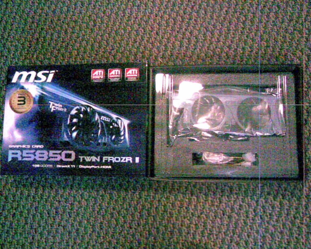

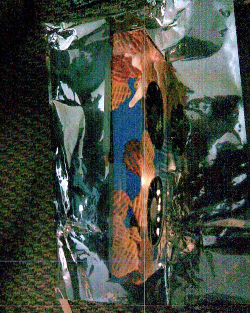

-Unboxing
Box has a bunch of spec on it (see below for details)

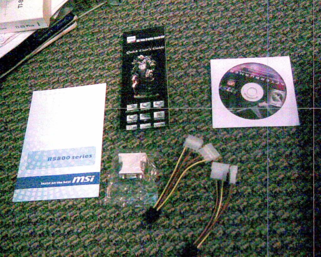

Stuff it came with. 2x Molex to PCI-E, Afterburner software (obsolete, see below), DVI to VGA adapter, NO crossfire bridge.

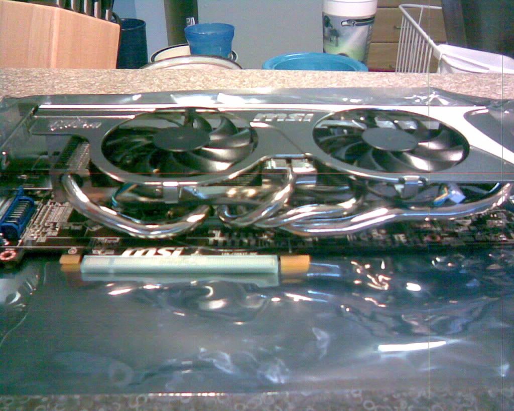

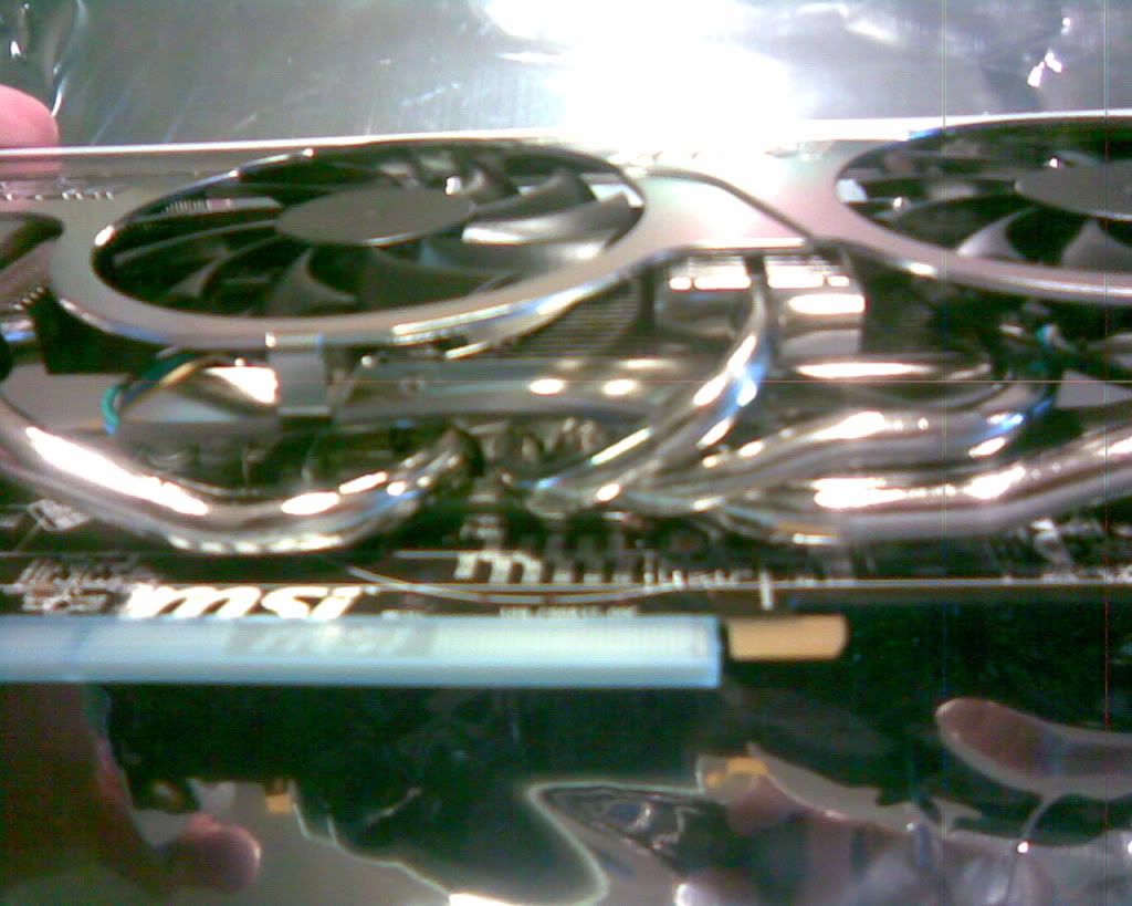

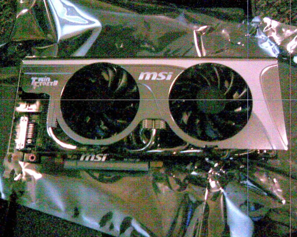

-Card Closeups

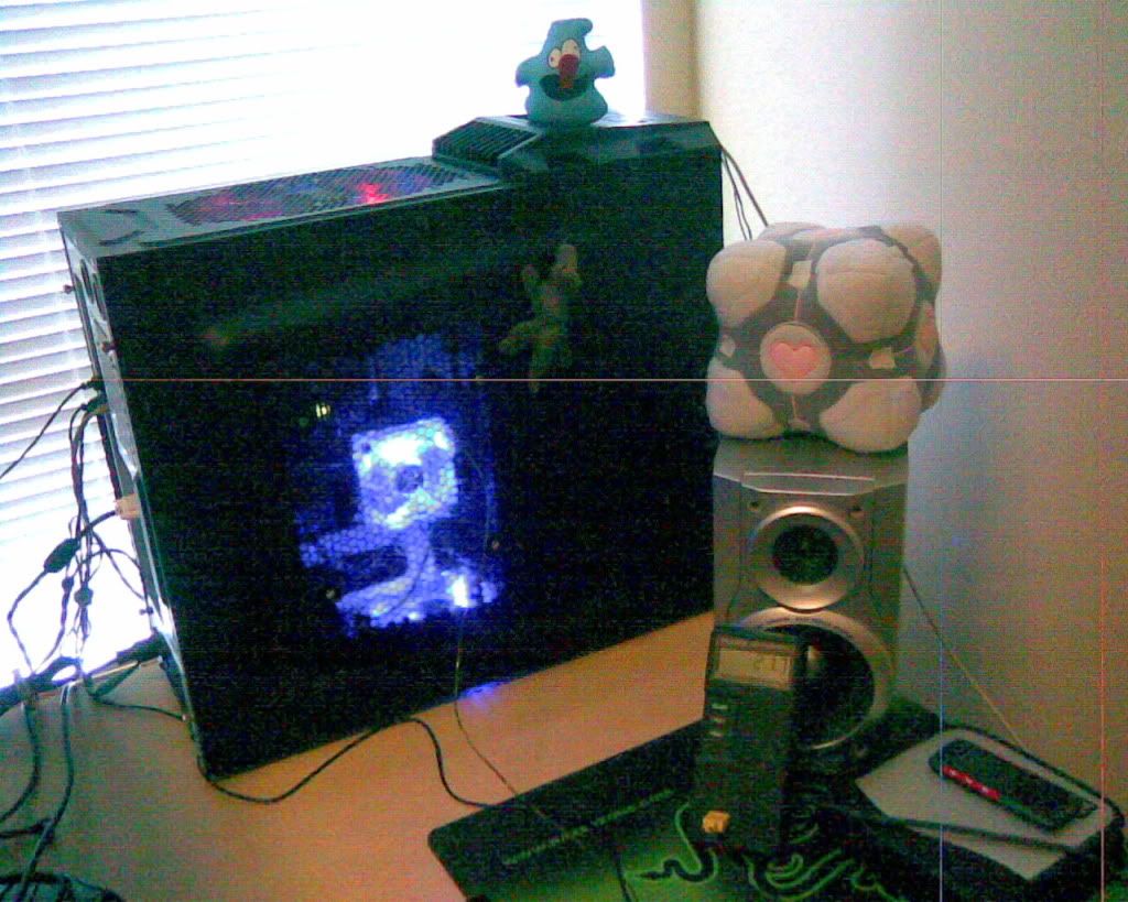

-Test Setup
This test will primary consist of comparing temperatures while running benchmarks and GPU stability tests. Not so much interested in how many more FPS I could get compared to the reference card.
Test rig (my sig rig):
-AMD Phenom II x4 965BE @ 3809.5 MHz
multiplier: x19.0, bus speed: 200.5MHz
-G.Skill Ripjaws Series 2x2GB DDR3 8-8-8-24-1T 1333MHz
-MSI 790GX-G65
-CM V8 CPU cooler
-Corsair TX650
-Samsum F3 1TB and Seagate Barracuda 500GB
-CM HAF 922
fan configuration - intake: 200-front, 120-botom, 80-window. output: 200-top, 120-back

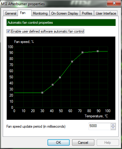

Both cards use the same Afterburner fan speed vs temp graph:

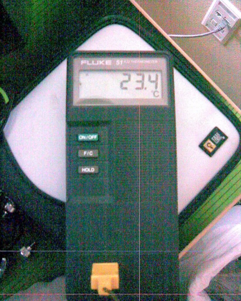

Ambient temperature sensor: Fluke 51 series, with probe positioed betweem VGA and CPU cooler
Initial ambients are about 21-23C. I opened my window after every test to get the hot air out before doing another test.
Overall setup (note the companion cube plushie)
-Interesting MSI 5850 Twin Frozr specs
All the specs are the same as any reference clock. Though I did find the core voltage to be 1.100V default as compared to my reference card at 1.087V. The fan comes preset to 30% as opposed to reference at 20%.
MSI says it has dual ultra quite PWM fans that provide 50% better thermal efficiency and direct airflow to cool the GPU. It has a large copper base coated with nickel that provides "feastest" heat dissipation (typo on the box). 8mm supper heat pipes. Ultra high-density aluminum heatsink has large area for heat dissipation. Claims 12C cooler under full load (shows a graph of the frozr vs a reference with the frozr at 76C and the reference at 88C, states "Results is based on 25C of system temperature). It has military grade componets including, highly conductive caps, solid caps, and solid state chokes.

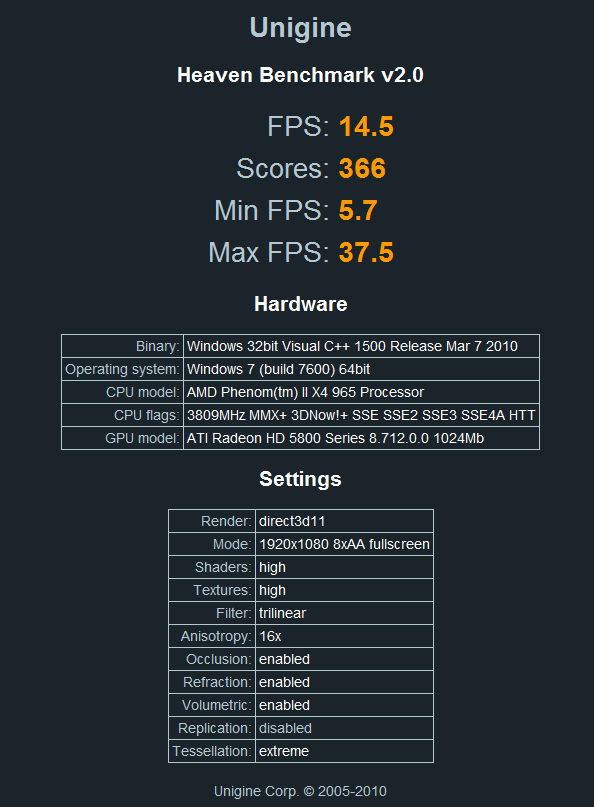

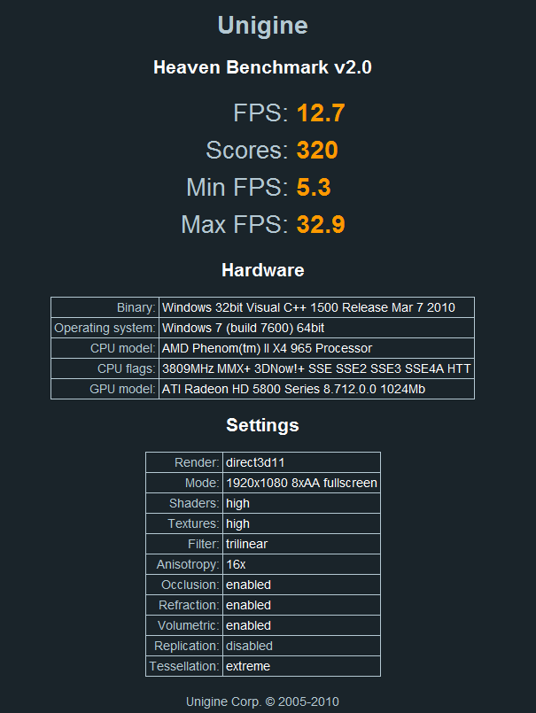

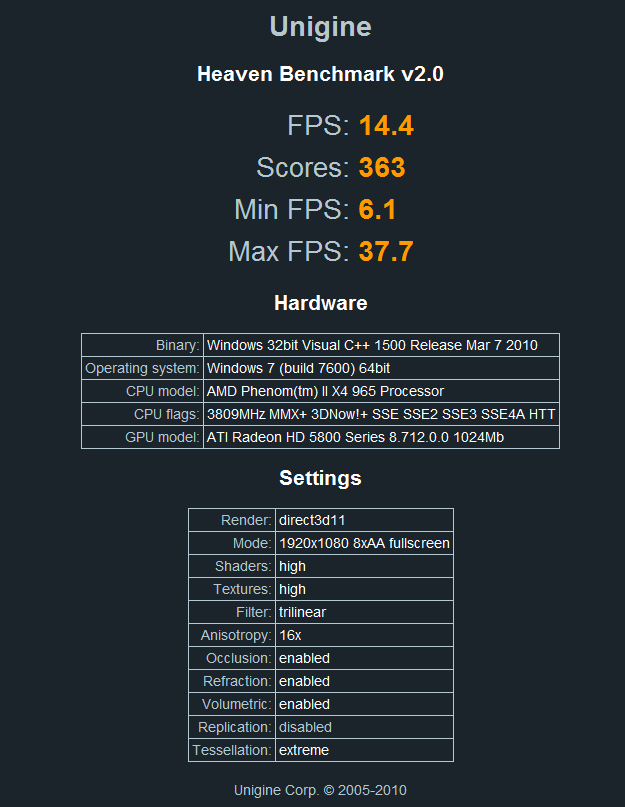

-Unigine Heaven 2.0
API: dx11
Shaders: high
Tessellation: extreme
Anisotropy: 16
Anti-aliasing: 8x
Fullscreen, 1920x1080

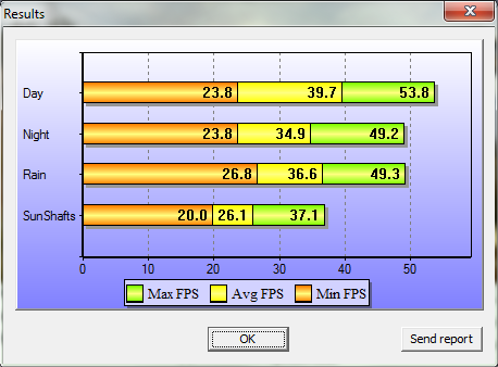

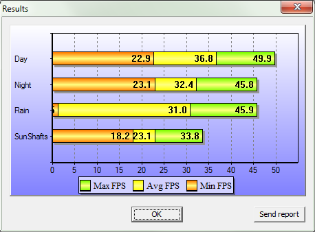

-Call of Pripyat
Preset: ultra
Renderer: dx11
1920x1080
MSAA: 4x
MSAA for A-tested objects: dx10.1 style
SSAO: HDAO
SSAO Quality: ultra
checked: use dx10.1, enable tessellation, contact hardening shadows

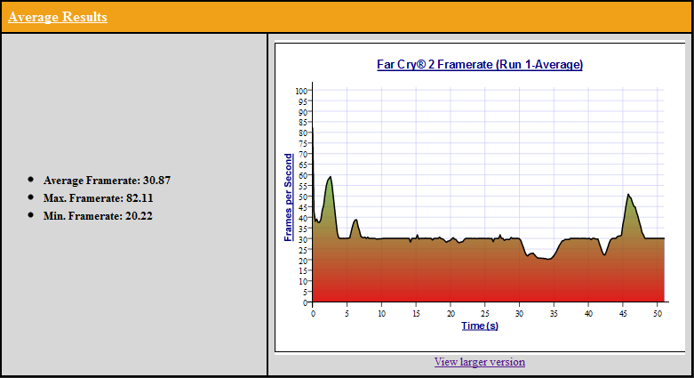

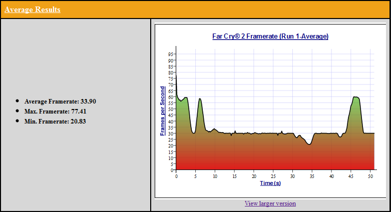

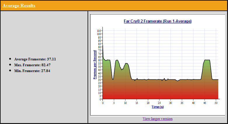

-Far Cry 2 benchmark tool
map: small ranch
1920x1080, fullscreen, vsync
Performance: all very high
Overall Quality: ultra high

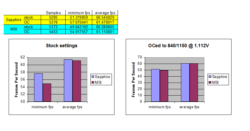

-Dirt2 benchmark
1920x1080, 60Hz, vsync
MSAA: 8x
everything else turned to highest setting

-Heaven
Sapphire stock
Sapphire OCed
MSI stock
MSI OCed
-Call of Pripyat
Sapphire stock
Sapphire OCed
MSI stock
MSI OCed

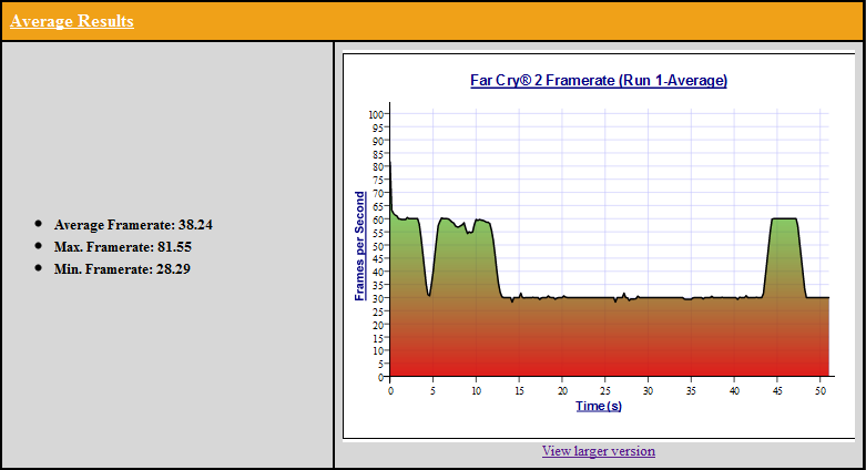

-Far Cry 2
Sapphire stock
Sapphire OCed
MSI stock
MSI OCed

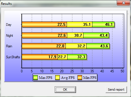

-Dirt 2
Data pulled form the XML dirt 2 produces

I initially bought the MSI card due to its advertised coolness, aka 12% less the reference, and quiter fan speed. The fan did turn out to be much quiter. Up to about 60-70% fan speed, the sound level is less than that of the reference. The temperature results of the MSI are a bit unsettling to me. While I see that the graph posted on the box is for very high temps (70C+), I would think I would see even slightly better temps at lower loads. Things get even worst with OCing.
Clock for clock comparison to the Sapphire, there is no noticeable FPS gain that I can tell. I expected this, and thus really tried to focus on the temps camparision.

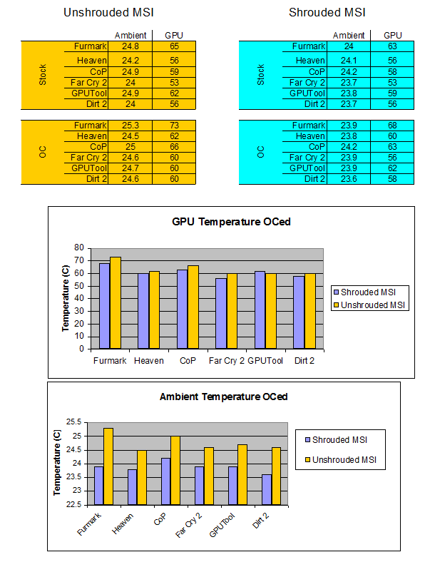

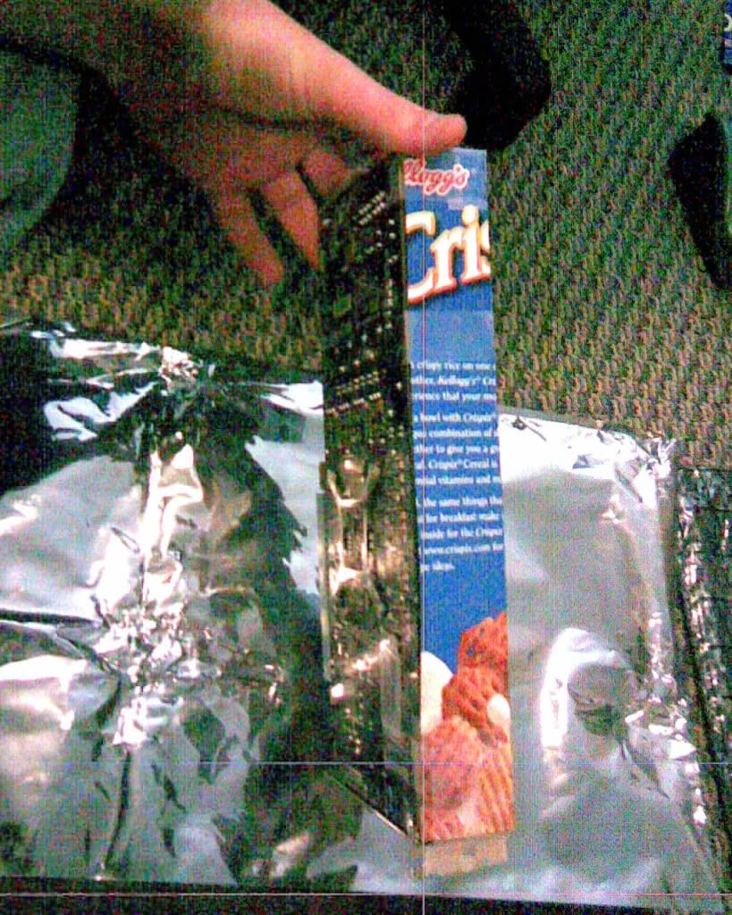

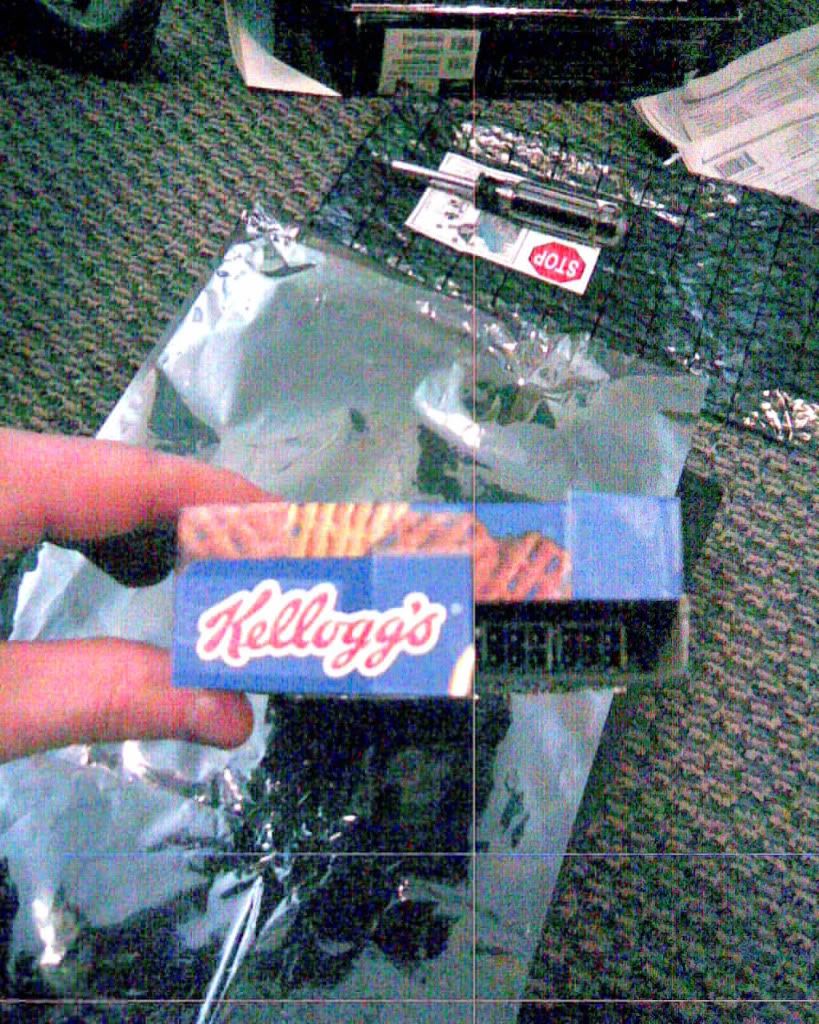

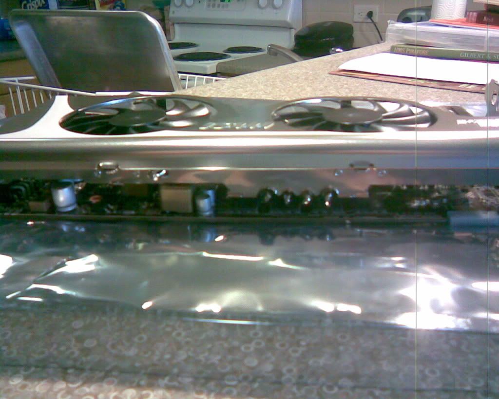

-MSI With cardboard shroud test results
Added a shroud to see if I could reduce the temps by more efficiently removing the hot air out the back. Without the shroud, the air from the fans will just enter the case. The shroud is made from a cereal box and cover the whole card with holes for the fans and held on with scotch tape. Also used the tape to seal other openings, though some still exist.
Ran the same battery of tests again in the same testing conditions. Temp results:
Very slight improvements in GPU temps, but big improvement in ambient temps. This is most likely caused by less leakage into the case.

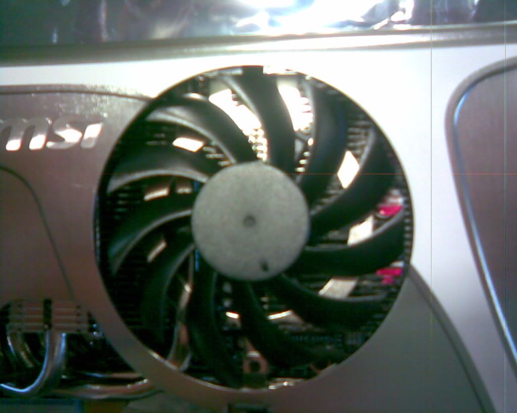

Over the course of the test, the fan noise was very minimal compared to the reference card. I have a few conclusions on this that also relate to the temperature:
1. The fan blades are significantly smaller than other cooling fans on other cards that are positioned on top of the heat sinks. Thus, there is less airflow and less noise produced by the fans.
2. Assuming #1 is right, then less airflow would mean worst temps compared to the reference. It seems to me that my tests support this.
Some how, MSI was able to produce temps of 76C on the Frozr and 88C on a reference, thus allowing them to say a 12C cooler card. This seems a little extreme to me, since none of my tests gave temps of this magnitude, though I am using a different setup and conditions (MSI doesn't state theirs).
If you are looking for a cooler card, I would say stay away and get a water block. If you want a quieter card, then this should be a consideration.

OP: Might want to have a look at your FC2 benchmarks.
One of them was run with Vsync OFF. Can you guess which one?? LoL
Yes, I do see that now. My bad. I'm in the process redoing the Sapphire tests, so I'll change that one too.

I noticed that there is practically no airflow out the back of the card, thus making the nice cooler pointless to me. I'm gona try to solve this by making a cardboard shroud.
3,534 Posts
Discussion Starter · #19 ·
Cardboard shroud. I'll get some tests done soon.
