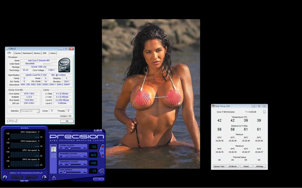

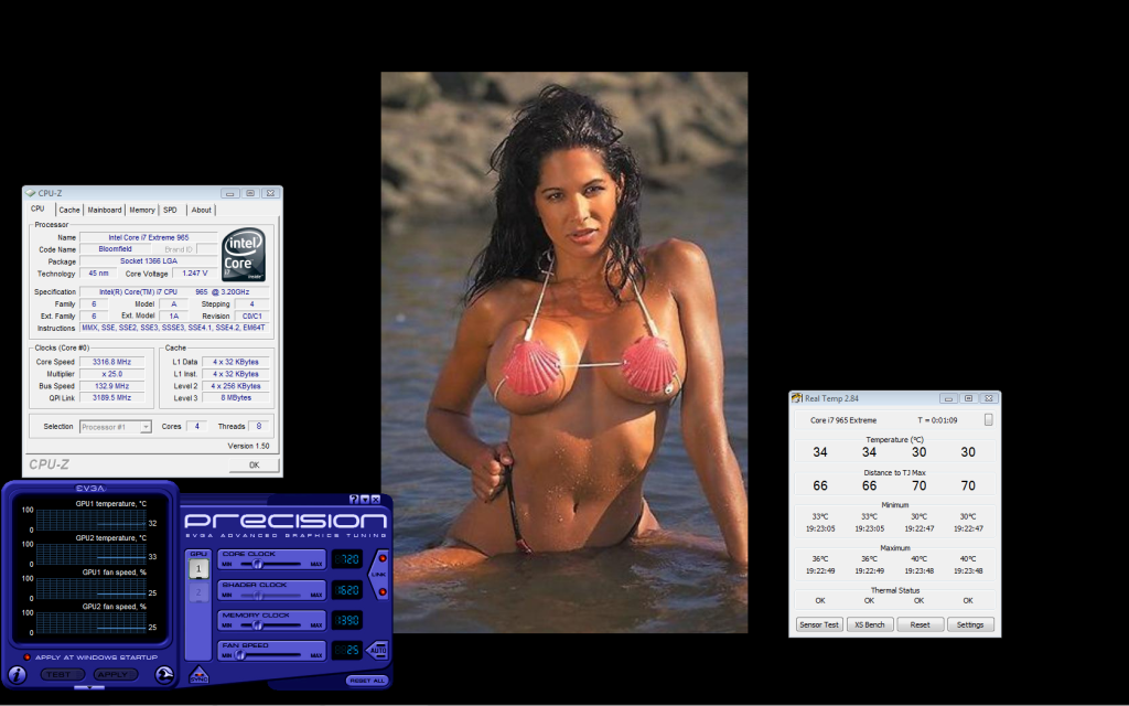

So I installed my HeatKiller v3.0 last night after taking out the Apogee GTZ. This is a very basic comparison. I took a screen show for both blocks at stock cpu settings and with a mild overclock at 4.3 ghz. These temps were taken when the cpu was at idle. Also I was using Thermalright Chill Factor paste when I ran this comparison, so better paste will yeild yet even better results. The temp in my room when I ran both tests was 79 degrees.

Apogee GTZ temps at stock cpu settings
Heat Killer temps at stock cpu settings
Apogee GTZ temps OverClocked to 4.3 ghz
Heat Killer

Thanks for posting those temps CDMAN
I just asked in a previous post what the temps for the HK WB were. You know what they say "the more the merrier" (or..., "the more testing samples the more accurate the results"

Thats a pretty good difference
How does that heatkiller compare to a D Tech Fuzion v2 though....

Thanks for the comparison. There doing real well on the i7.
Did you do any remounts on the HK? If not you might want to do 4 or 5 and see if it will go any lower.

Stupid question, those appear to be just idle temps?
I think your right, the i7 run a lot hotter don't they. I was thinking those were a load temp.
Yes those are both just idle temps. I plan on remounting the block again next week when I get my new computer case.

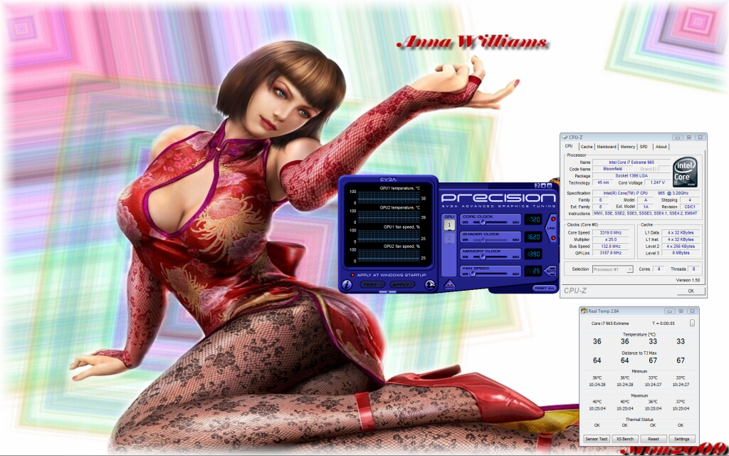

here is my heat killer screen shot.. lol . it is worthless because my XSPC bay res. paint flaked off on the inside, and completey messed up my loop !
so now i have to try to get the paint chunks out of the 2 radiators, and the tubes, pump ect...Still not bad for a bottom line 920 though. lol
