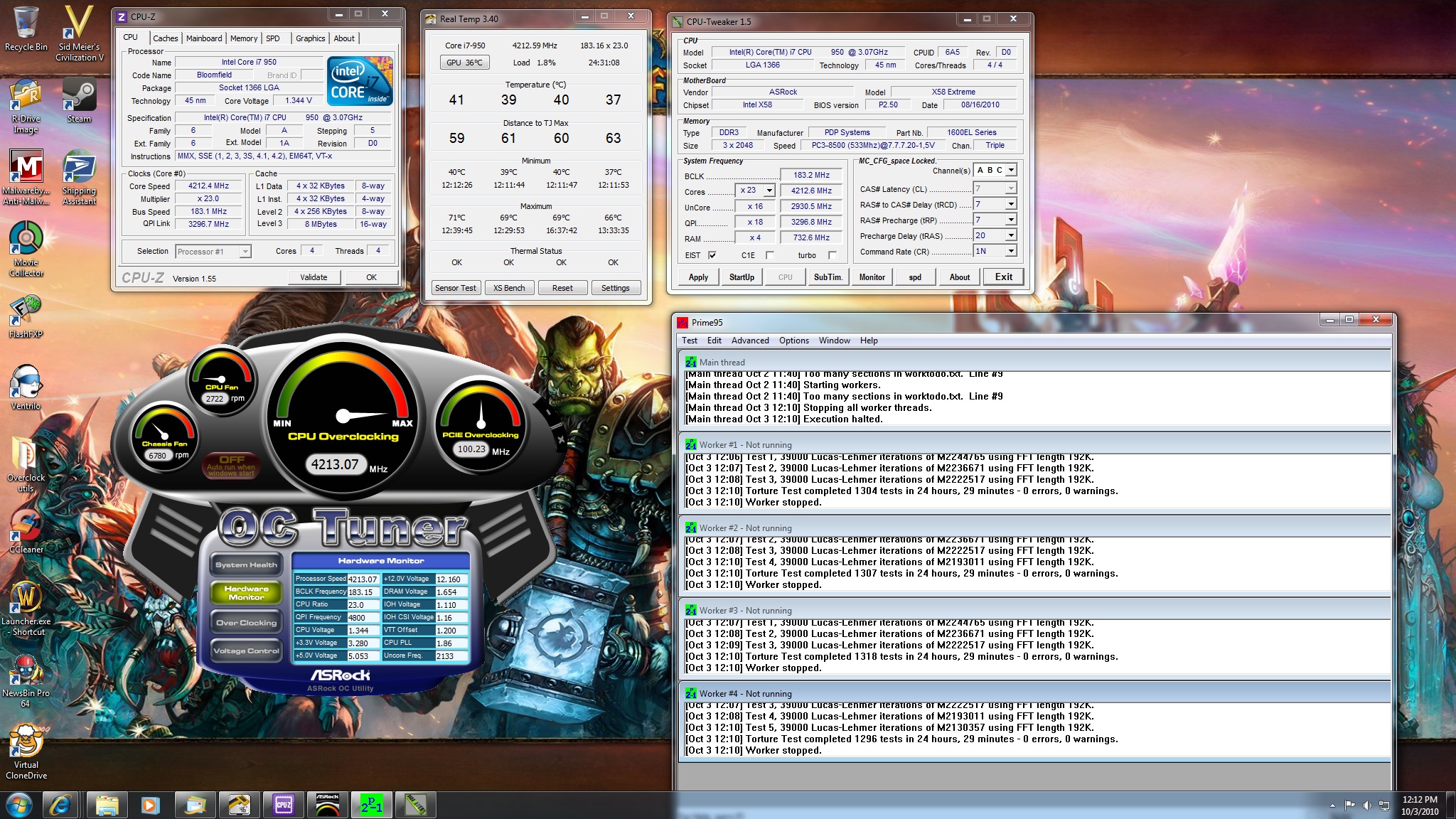

Finally completed my 24hr prime run and thing I am gonna call this system done. Temps seem good and stability should be solid.
+1 for the Thermaltake Frio. I think its a great cooler and it dropped my temps 10C from my old Zalman 9700.
Such a long wait for a 24hr run!
My tips:
Keep VTT low.
98 Posts
VTT is the minimum I could set in the BIOS - 1.20
The ram is running at decent timings and DDR-1460. The ram is rated at DDR-1600, but my next step up in multi puts me at around DDR-1800 and I could not get it stable at that speed. Probably more to do with the fact I had to rais uncore speed to get that multi and I am not stable with the higher uncore speed even raising VTT up to as high as 1.4.
Originally Posted by homestyle
good job. your ram multi looks a bit low.
how much voltage are you giving vtt?
98 Posts
Not sure if it is the MB or not, but I seem to hit a Bclock wall around 185, at any multi, so I had to boost the multi to 23x.
Originally Posted by paulo dourado
you can get better performance by using the 21x multi and an 18x uncore. on my system 4.2ghz using the 21x is comparable to 4.42ghz using the 23x
