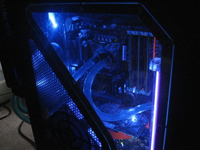

Well, here is what I have coming to my house so far
  • Swiftech H20 220 Compact purchased from Mothow (reservoir, pump, radiator, external mount, additional radiator, fans)
  • 5 feet of 3/8" tubing (Primochill Pro LRT Tubing)
  • Danger Den Core i7/1366 Waterblock with 3/8" barbs
  • Clamps
  • Feser Blue UV Reactive Liquid
What I am going to try is with the Swiftech unit I purchased the pump and CPU block are one unit, but it only works with the LGA 775 and not Core i7.
Next week when I have more money I will be upgrading the kit with a Thermaltake Aqua Bay M5 http://www.frozencpu.com/products/55...tl=g30c321s823 and with that I should be in even better shape.
I plan to set it up:
  1. the output of the reservoir will be fed into the input of the pump
  2. the output of the pump will be fed into the input of the CPU water block
  3. the output of the CPU water block will be fed into the input of the radiator
  4. the output of the radiator will be fed into the input of the reservoir
I cannot see why I cannot use the Swiftech cpu/pump combo as a pump only though. Just have to figure out a good way for it to be mounted temporarily. At least until I can add that Thermaltake kit to it. I will be adding my Chipset and both 4870 video cards to the loop later. By then I am hoping to have been able to piece together my whole kit, or at least use the Thermaltake as the foundation.
The total cost of everything: $150.00
So My adventure into water cooling has begun. Thank you again for all the advice and will keep everyone posted on how it turns out, also I will post some pics.
Any advice on how I can work the air out of the system first before use?
The pictures I promised of my new water cooling system installed in my Antec 1200.
Thermaltake P500 Pump (for now)
Swiftech MCR-220 240 MM Radiator with Rad Box
XSPC Delta V3 CPU Water Block with Core i7 Plate
1/8" Primochill Tubing
2 Scythe Ultra Kaze Low speeds for pull
Worm Drive clamps
