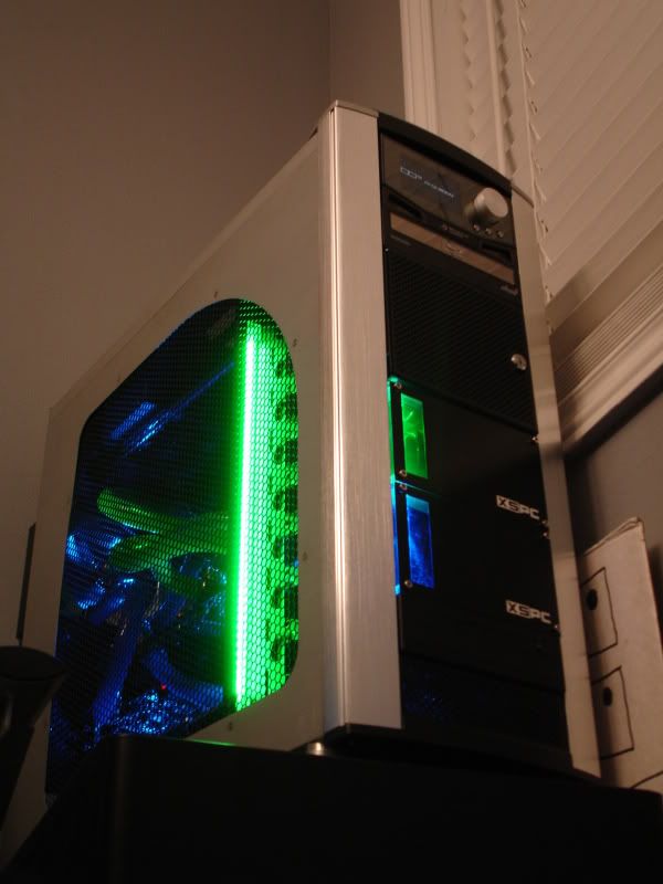

Sucks you had a bad experience... I have been running 2 of these 24/7 for 11 months solid without a single problem *knock on wood* I love em
