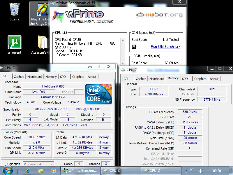

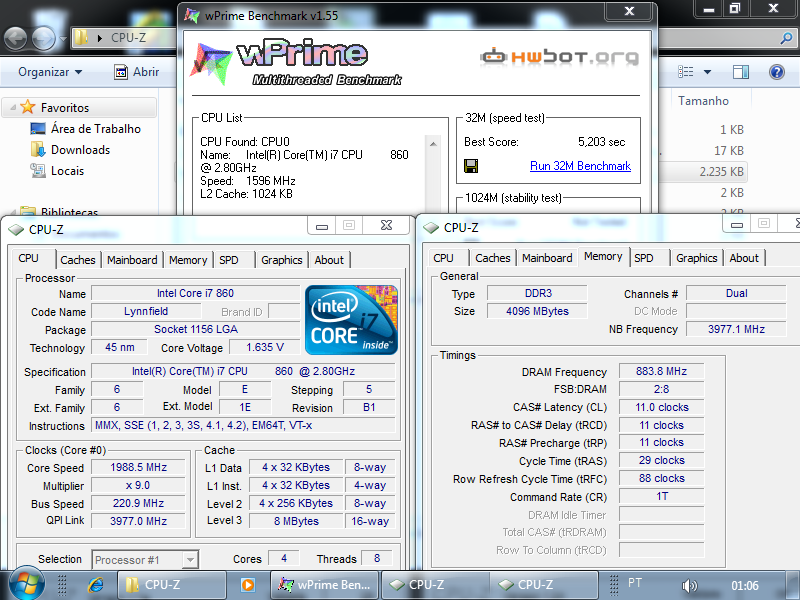

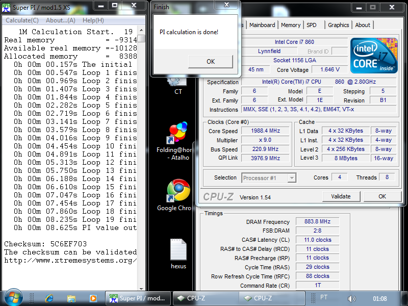

Today's results:
http://hwbot.org/community/submissio...50_5124.93_mhz
http://hwbot.org/community/submissio..._650_18.09_sec
http://hwbot.org/community/submissio...650_8sec_469ms
http://hwbot.org/community/submissio...in_15sec_516ms
http://hwbot.org/community/submissio...min_7sec_265ms
http://hwbot.org/community/submissio...650_9sec_719ms
I didn't manage to play very well with the Core i7 860 since I got tired and ran into a series of problems related to it not wanting to boot at previously fine settings. I think this CPU just isn't very good for overclocking. Took 1.55V VTT and 102MHz PCIE for only 220MHz BCLK.
My brother is sleeping in this room so I can't fire 3D benchmarks up. Too bad I guess..
