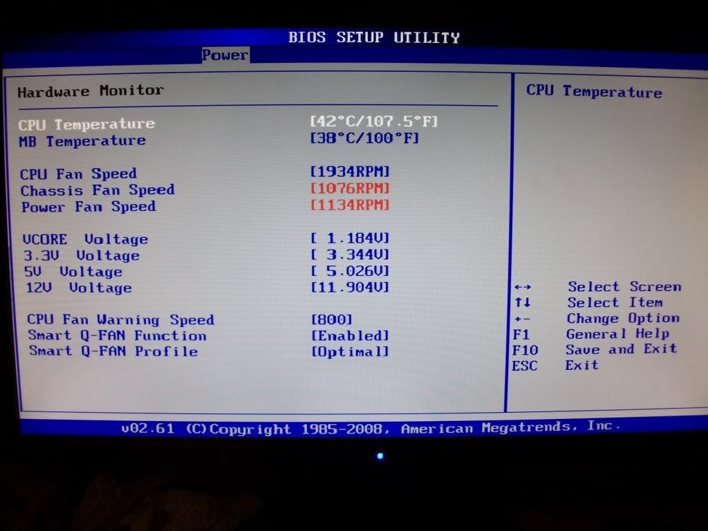

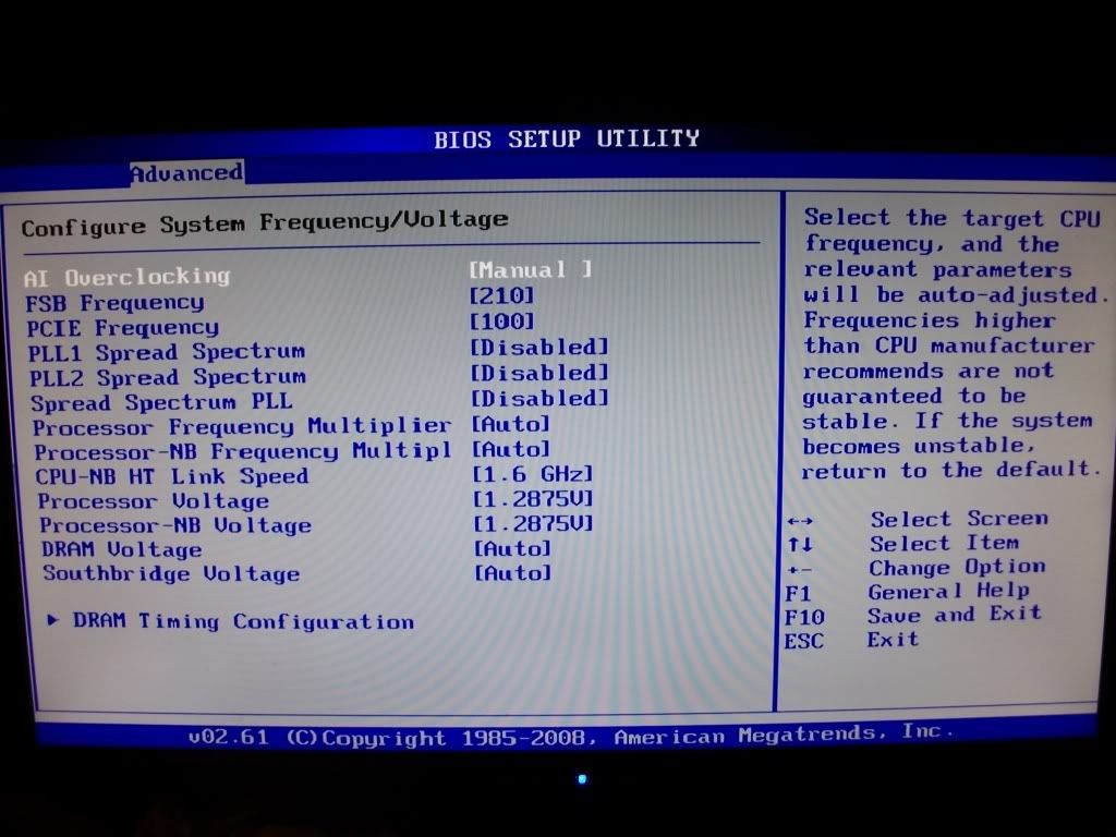

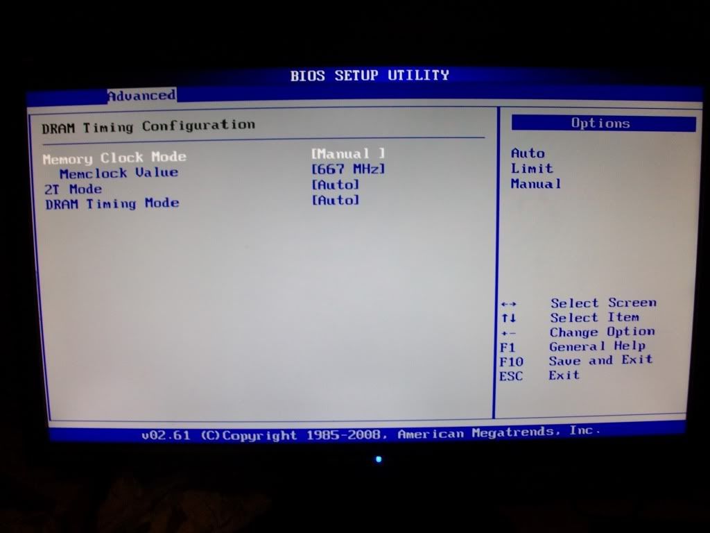

What I've done so far is nudge my DRAM frequency back to 667Mhz and my HT frequency back to 1.6Ghz (from 1.8), I then nudged my FSB up from 200 to 205 and booted back into windows.
Everything seemed fine, I ran a 10 minute stress test in OCCT and no problems.
So i rebooted again, went into the bios and nudged my FSB up to 210.
Herein lies the problem however.
As soon as the FSB gets to 210 the computer refuses to boot, i save the settings and exit the bios and my PC will just sit there for a while before rebooting and telling me the Overclock failed.
I figured this might be something to do with my NB needing more voltage so i bumped it up to 1.2875 in the bios (from what i could find i think my NB is at 1.25 originally).
The computer then proceeded to boot up, but once the stress test hits 100% load it BSOD's.
So i thought, maybe the CPU needs more volts too.

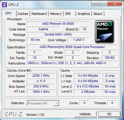

Now there might be a good explanation for this but one thing i noticed when i put the CPU volts up in the Bios is that, according to OCCT the volts actually drop...
Is there something else I should be changing?
Or am i changing the wrong settings all together?
Any help to set me on the right track would be very appreciated, I'm not expecting miracles from my trusty old Phenom but if I could get it up to 2.5 or 2.6 I would be very happy.

@Bloodbane, up your CPUvcore to 1.4v and go for an FSB of 220. Make sure your RAM stays under its rated speed, so you can figure our where instability is. You do not need to put the CPU/NBv up since you are not overclocking the northbridge atm.

I assume that I should just up the "processor voltage" until the bios is showing my Vcore as 1.4v?
Because as i said, the processor voltage setting doesn't seem to directly correspond to the reading i get for the Vcore.

Alright, i gave it a shot but it still bsod's under max load...
Funny thing though is when i set the processor voltage to 1.4 in the settings it actually drops from 1.248 to 1.2 according to OCCT and the Bios.
I tried going to 1.5 to see if that would make a difference but my sound went distorted and it froze on loading windows, i checked the Vcore reading in the Bios but it still showed Vcore as 1.2.
Any other suggestions?
