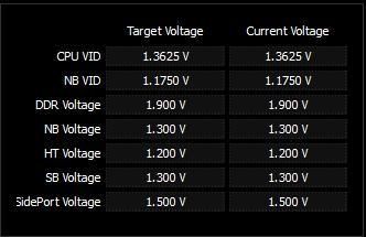

Hmmm, that is kinda low for the NB.
Did you pick that voltage on a whim, or is it specified in the mobo manual?
As far as I know, 1.25v is stock. I'm running at 2200 MHz, 1.33v
Actually, just to clarify, I'm talking about the processor-nb voltage.

current voltages.. all set back to default after system crashed a minute ago.. so i know they're stock, except for the core of course. default is 1.250v.
