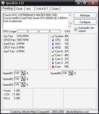

I'd been wanting to overclock for a while, so I ordered the Tuniq Tower last week. It's idle temperatures seemed ok (mid-30s if I remember correctly). After some research I tried overclocking at 337MHz FSB x 9 Multiplier, with 1.325v. This is what speedfan told me:
On the warm side. I ran Prime95 for two minutes and it reached this:
Scared me, so I put a stop to that. I think I have a more-than-ample layer of thermal grease under the Tower, so it's hard to imagine that's the problem. And I have its fan running at ~2000rpm. Only thing I'm worried about with the cooler is about a 1mm sag furthest away from the motherboard. I have tightened screws, but it persists. Problematic, or no?
If speedfan's "System" temperature is the ambient (I'm assuming it is?), it seems too high. One of the Tempest's front intake fans stopped working, possible cause, or maybe it's the 750W PSU?
My first overclock, so go easy. I'll consider my failed attempt a learning experience.

Could be a combination of several things.
(1) You might need a reseat.
(2) You could of used too much compound
(3) How is your air flow?
(4) What is your ambient temp?(room temp)

There's your problem.
Apply your thermal compound (which one did you use BTW?) according to this video.
I'm a little concerned about the airflow because 1/2 of the front intake isn't working, but I think it's decent, in general. Room temperature is about 70F/21C. My thermal compound (Arctic Silver 5) stays between the surfaces, doesn't seep over the CPU's edges. Is it possible that it's still too much?
I reseat last night, but I could try again.
EDIT: Hadn't seen your post, GSingh - I will clear it off and try to apply like in the video. I definitely used a LOT more than shown there. Screwing the Tuniq Tower back in is extremely tedious, however, because even with my small hands I can't get the back screw in with it centered. I need to rotate the tower slightly, so some of the compound will get smeared.
Ya, I would recommend a Re-seat. You shouldn't be getting temps like that on idle. Make sure you use the dot method in the center and the HSF will spread it out. Too much thermal paste is bad. You are just trying to fill the gaps with the TIM in where the HSF and the IHS are not making contact. Should fix your problem.
