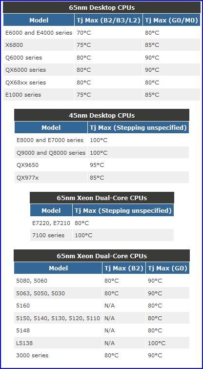

What is the TJ max for a q9550 E0 stepping? Right now in core temp it is set to 100 and my temps are 36C highest of all 4 cores and that does not seem right for a watercooled 45nm cpu. I got lucky and i got a 1.2000 VID but it also drops to 1.1000 in core temp but that is probably from LLC.

It's 100C I beleive, lemme check here.
Ok here it is: (hope this sizes right for you to see it)

Originally Posted by doat View Post
I see thanks. Why are my temps so high though or is that normal?

that chart can't be right...
I have a QX6850, and set TJmax in realtemp to 80C, and it tells me my idle temps are around 12C... and then under full load small ffts it says I'm hitting 27C
Uhh that does not sound right to me lol. 27C is around 70F unless you are using liquid nitrogen or dry ice i think your TJmax is off.
with real temp, and leave my TJ max set at default(100C) I get idle temps of32-34C and full load small fft's I hit 50-52C
