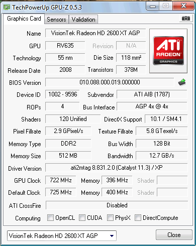

What voltage is he running at, and can I get a Gpu-z screenshot?
Also, if you can try and get a photo of the stock cooler it would help, mine was horrible. With my current overkill industrial grade cooling setup, I idle at 25-29c at stock, and load at 31-35 at stock, and load at 40c with my sig rig OC
i just updated driver then. its called its self vision tek 2600 xt AGP for some reason. i try to update to hotfix but it says its not the right driver or something. i will get a screenshot in a sec. i started to play cod 4 and it was fine 125 fps.. then it froze then screen said no video input
Odd, usually when not using the hotfix it should show the right gpu-id. Mine is labeled the same, but it doesn't prevent me from over clocking and over volting like I have. Try and look for older versions of the hotfix, I'm heading out for the night but if you can get a photo of the card that would be great.
