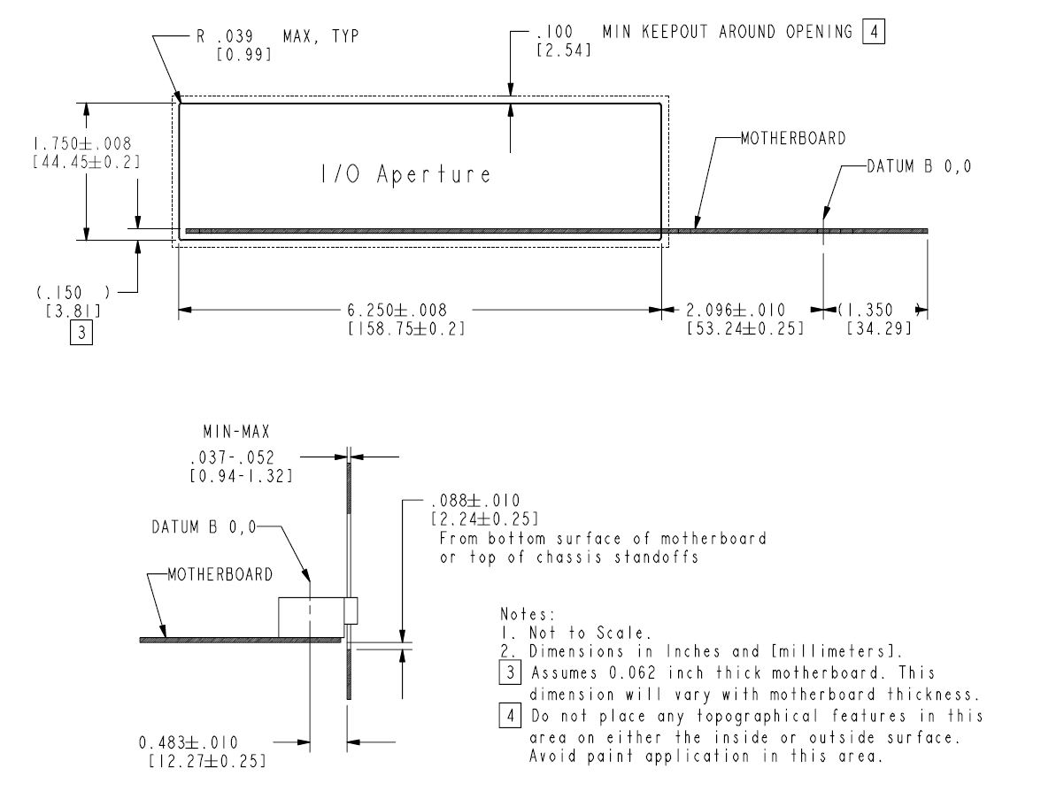

I'm still convinced that a 140 mm radiator actually could fit up front without blocking the GPU. The IO plate on the rear is 158 mm, I think that's a good ballpark as to the usable width up front. That's a conservative number as well, since the case side and GPU are spaced a little off that.
The MCR140-X is 140 mm when mounted upright. In interviews with Swiftech they are adamant about the rad being no wider than a fan for case compatibility. The SG13 is 181 mm tall, so height is fine as well. I guess I'll just have to drill some holes in the case if I want to use a long GPU and 140 mm loop.
