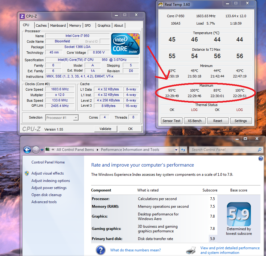

I just finish building a new comp today. After I installed windows I ran the windows assessment to test the system under load. While running the assessment my temps peaked at 95-100 C in real temp!
Can anyone tell me whats wrong?

I used AS-5, possible alittle more than I wanted. Should I remount the heatsink?

I reapplied the thermal paste and remounted the heat sink nice and tight but my temps are still too high. I don't know what else to do. Should I try a new cooler?

Ambient is around 24-27 C and its sitting under a desk with only 1 side against the wall. Location is definitely not the issue here, I ran in my downstairs workspace out in the open(its also cooler downstairs). Im its running about 48-50 C idle ATM.
I think Ill try the stock intel heatsink tomorrow and see what happens.

So I tried the stock intel heatsink, the CPU idled at around 70 C, so its definitely not the heatsink.

Ive tried every avenue, different heatsink, different thermal paste, different fan directions and I still can get the temps to go down. So I guess Im going to fry's tomorrow to get a new chip.

Yep, it was a bad chip. Just put the new one in and it runs 20 C cooler.
Heres the info of the bad chip:
i7 950
SLBEN Costa Rica
3025A706
