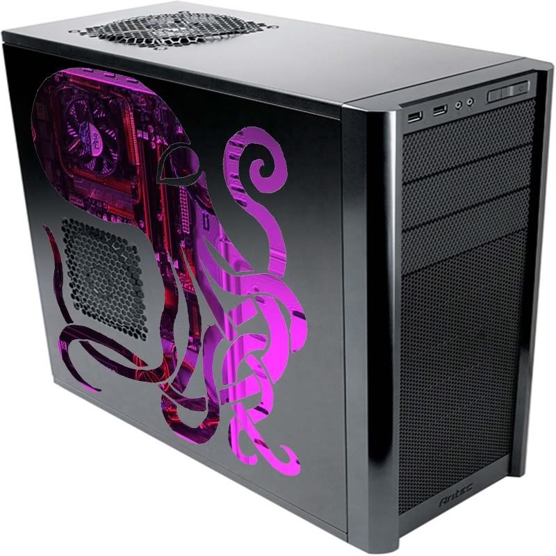

right, so after nearly a year of having my antec 300 and allowing the plan and image to form in my mind and on paper, i am at last begun with my first mod on my first build. when i do something i jump in head first, nothing half-assed for me. this mod is simply a stylistic window in the likeness of the sea-floor-sleeping elder-god Cthulu, and the screaming need for a new paint job.
The Case: antec 300, you know it, you love it, yes, it's small. i'm gonna make it better:D
The Sketch: who doesn't love graph paper?
The Plan: a little photoshop manipulation and we have a rough idea of the future beast in my living room.
maybe a custom cthulu fan grille?
now that i've outlined the goal, i can show you the story so far. today was a groundbreaking day for me. i sanded most of the paint off the case (shiny!), drilled out about half the rivets (until the drill bit broke:() cut some holes for cable management ('cause let's be honest, this case needs it!), and started cutting out the stencil i pasted on the inside of the panel. here's the results:
The Abrasion: like i said, shiny!
The Penetration: by way of making holes....
one for the psu exhaust.
three for excess cabling.
i'll use my own fan grilles thank you.
The Viewport: the exciting part
stencil, remaining work
The Refuse: maybe a wall decoration for mom?
as the sunwent down so did my supply of cutoff wheels. it became a race to see how much i could do before running out of either. 25 cutoff wheels later... am i doing something wrong? too much pressure i reckon.
work for the weekend now, then i get more, new drill bit, some paint, rivets, etc. more tuesday.

what kind of tools are you using for this? it is looking very nice, and i would like to see how you are making such smooth curves while cutting the metal. it seems like that would be difficult with a dremel with reinforced cutting bit (what i have)

Really impressive work, your cuts are clean and that eye must have been a few minutes of nervous cutting work.

i imagine you will be using a sweet fan grille over the side fan? that could turn out very sexy!

yeah, nervous indeed, but i'll be sweating for sure when i get to that tentacle bit that looks like celtic knotwork!

a dremel 300 actually, the best cutoff disks were the ones that came with the tool, the "heavy duty"s i bought for the purpose, gave out disappointingly fast.

there's a template displayed in the OP, necronomicon glyph for cthulu. i expect it will be the hardest part of the whole cutting project!

today was cycling around in the rain collecting tools and the like. came home with enough time to finish the detail cutting on the side panel window.
this one's for the haters and non-believers, myself included.
i'm not going to lie to you, right now. this was the hardest bit:
seriously, i can't believe i actually pulled that off! now my dremel hand is tired and i believe i'll be waiting a few days before i continue on with the final cutting project: the fan grill of doom:
now that's a good use for scrap metal!
i also drilled out the majority of the rivets in preparation for painting. as you can see, i have left the hard drive cage and the 5.25 bay cage intact and attached. i intend to rotate the hard drive cage only, so i can access them through the side panel and free up a couple of centimetres for the pci-e cables.
foreshadowing:
i swear they just fell out of the bag like this! <---(liar)
