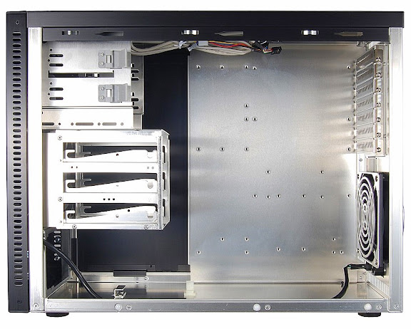

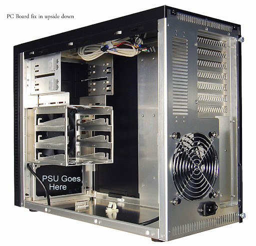

Lian Li PC-A05 Aluminum Case
"The Lian Li PC-A05 Aluminum Case is the very first budget style case from Lian Li. This case has four 5.24", one 3.5" and three 3.5" hidden drive bays and One Back fan. This case has been through several different Models since it's inception and a little modding is all you need to allow good air flow. While this case has all the essentials it doesn't have a removable motherboard tray but it's well priced and has great build quality." Rodney Reynold's. Video Reviews.
Specification
Model.................................................. .................................................. ....... PC-A05N
Case Type............................................ Mini Tower for Full ATX and Large Video Cards
Dimensions............................................. 210mm Wide x 381mm High x 490mm Deep
Front bezel Material.................................................. ....................................Aluminum
Color................................................... .................................................. .. .Silver / Black
Side Panel.......................................Plain No Windows but Windows are easy to install
Body Material.................................................. ..............................................Alum inum
Net Weight.................................................. ...........4kg or 8.8 lbs Very Light and strong.
5.25" drive bay (External)........................................ .................................................. ...2
3.5" drive bay (External)........................................ .................................................. ..1
3.5" drive bay (Internal)........................................ .................................................. .......3
Expansion bay Slots.................................................. ........................................7
Motherboard.................................................. ..........................FULL ATX, M-ATx
System Fan (Top) (Front)........................................... .................12cm Ball-Bearing Fan x 1 (1500RPM)
System Fan (Rear)............................................ .................12cm Ball-Bearing Fan x 1 (1500RPM)

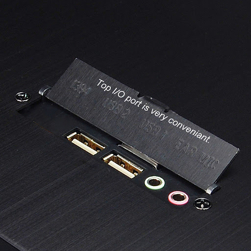

I/O Ports.................................................. .......................USB2.0 x2, HD+AC97 audio

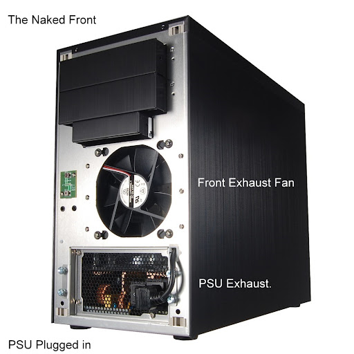

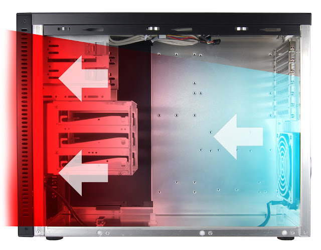

Q: What is the Direction of the Airflow in the Case?
Fresh Air is pulled from the back and exhausted through the vents in the front. This means your CPU gets the coolest air first. There are two 120mm fans in the case: one in the rear Bottom and one in the Center front. Exhaust is via the front 120mm fan and the PSU which sits below it.
Q: Doesn't this mean that the PSU will run hot?
Not at all. There is about ½†clearance under the PSU for air if you have the fan face down. There are holes under the 3.5†hard drive cage for airflow if you want the fan facing up.
Q: What about graphics cards temps? Won’t they run hot?
Graphics cards will run warmer in this type of case by 5c-10c. This problem is easily fixed. Most of us modify the top and add a Blowhole Fan or buy the replacement top panel (T-LM14B-2) which is a replacement Top and has a cut out and Shroud for a 140mm fan. Unfortunately these seem to be out of stock just about everywhere. It is best to use a 4 1/2 inch Hole saw with a drill attachment.
Q: What is the benefit of inverted ATX?
For one, the Hot Video card is up high and away from the CPU Cooler. It allows for a smaller more compact case. It also allows your to run very cool since the heat of the Video card is not convecting hot air up into the CPU like most Cases. Instead very cool air is blown onto the CPU heatsink first. You will not find a case that can provide better temps for your CPU.

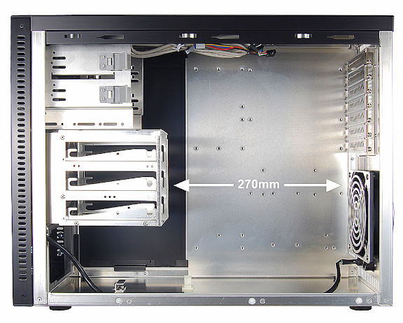

Q: What is the longest graphics card that can be installed in the case?
This is entirely dependent on the layout of your motherboard. If you look at the pictures of the case you can see that if your first PCI-E slot sits in the first two slots nearest the CPU socket then the max length will be around 10.5†because the card will butt up against the 3.5†cage. 11" if you have HDD in the top slot clear. If your GPU sits in the 3rd or 4th slot than you can fit a GPU that is 13†long.

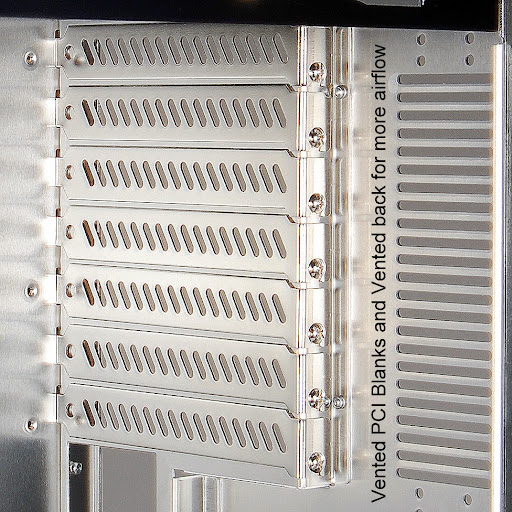

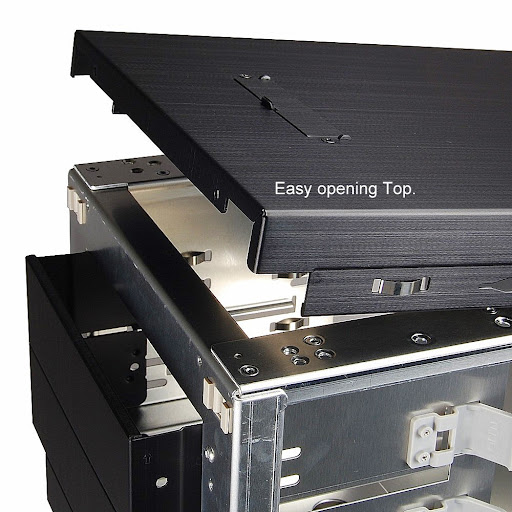

Q: What is the difference between the A05B and A05NB?
The A05B was the first revision of this case that was released in 2006 through 2009. The A05N is the newer revision that added a few improvements to the inner design.
These improvements are:
  • A completely Removable top panel
  • A Removable 3.5†Hard drive cage
  • Vented PCI slot covers on the Back
  • Newer HDD cage
  • Cable management holes in the Motherboard Tray
  • Round Status LEDs instead of oval
