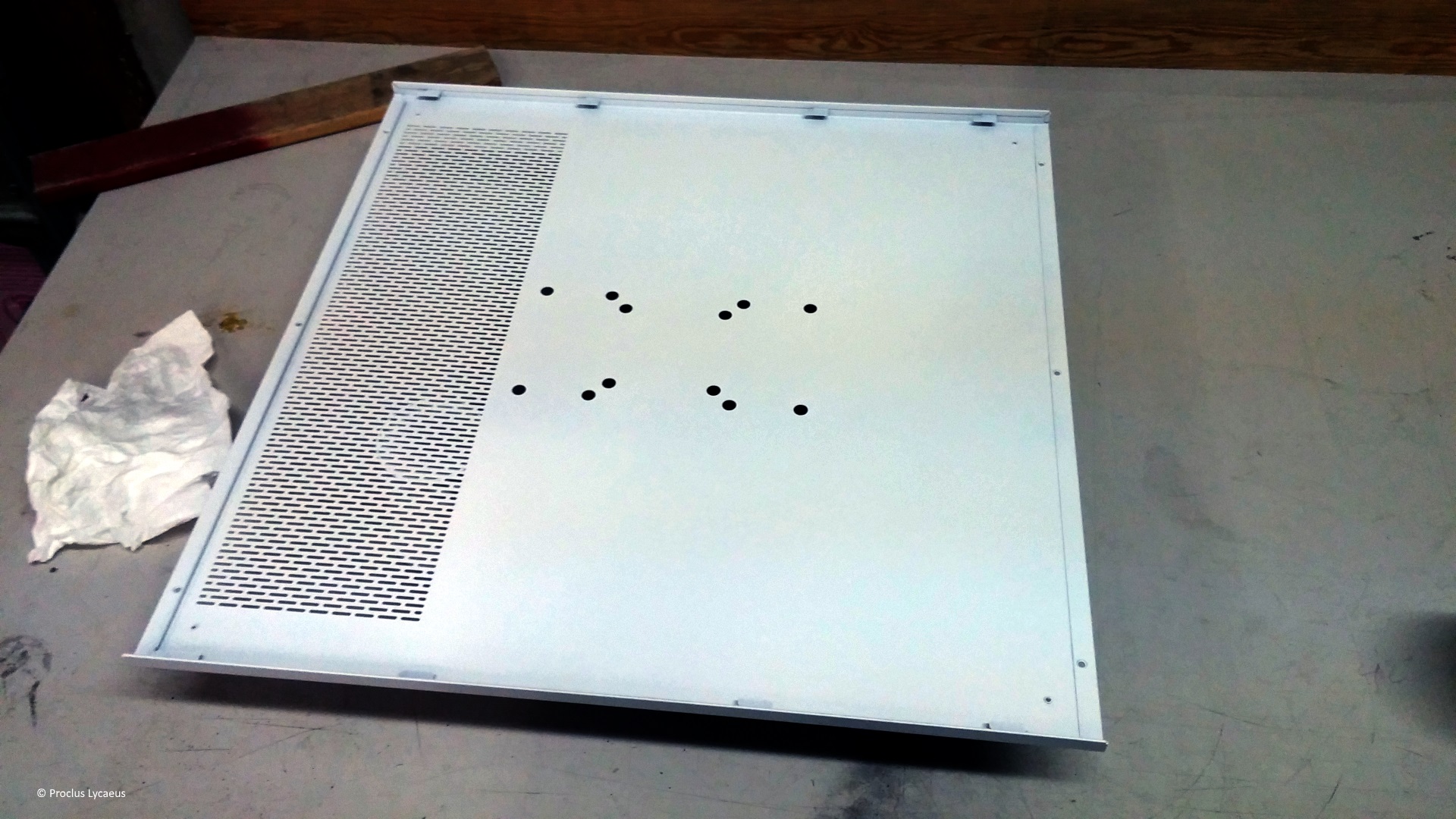

I'm starting my build now. All the parts finally came in, and I'm slowing starting to document the build. I love the case. While I have the feet on it now, I plan to mount it to the wall when I'm done.
So far, I am VERY impressed by the build and material quality for a $149 case. It is very solid and well thought out.
Here are all my goodies.
Here are a the core components mounted so I can verify that there were no major components that were DOA, and so I could load up the operating system.
Even though the case says it only mounts motherboards up to ATX size, it will still handle an E-ATX motherboard ... it just gives a little less room for the cables to pass through.
I plan on mounting everything up and since I'm not using just Thermaltake parts, I will have to drill some custom holes and such. But the biggest mod will be that I plan to use a single sheet of white acrylic to cover the whole black metal frame, so the components will stand out even that much more, and there will be no unused holes.
