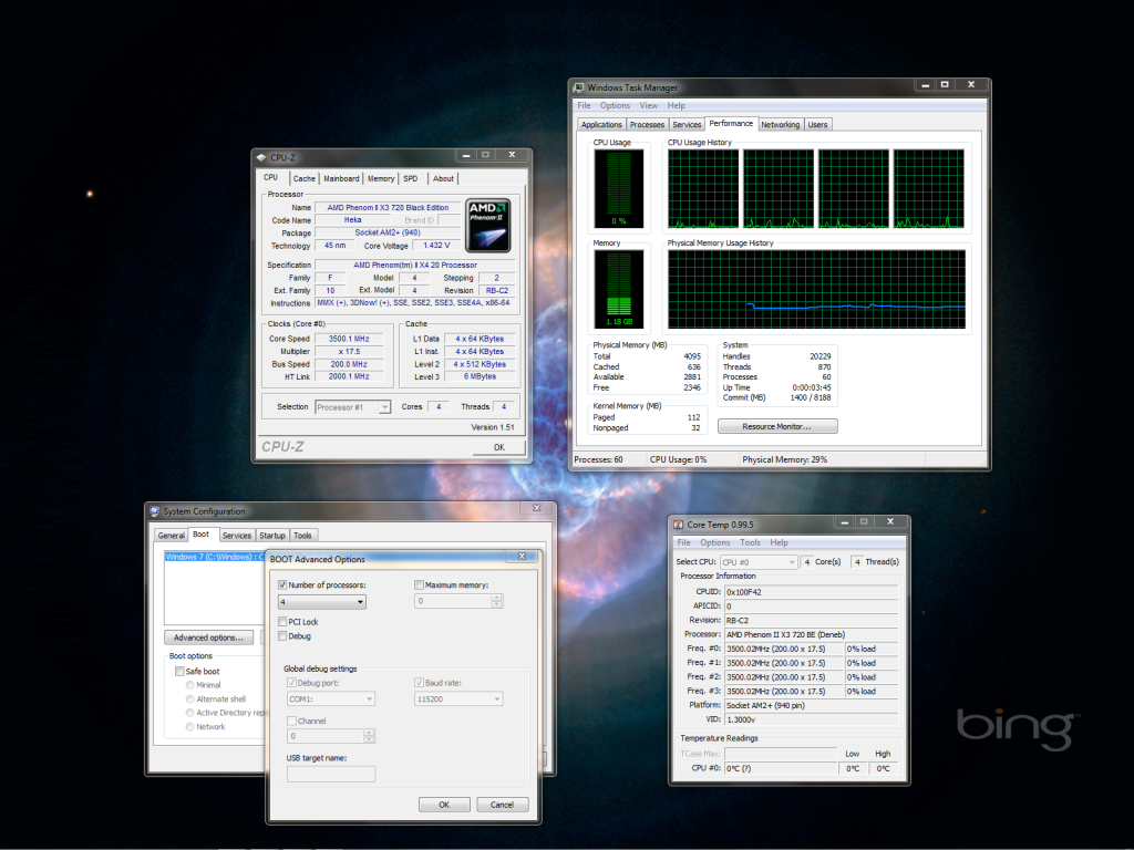

My 770-G45 cost $90 when I bought it.
Its held stable overlocks of my X3 @ 3.7Ghz, and now with its built in unlock 4th core feature, AAC ability and some fine tuning by yours truly, I know have a fully tested and stable quad core.
Your temps are the #1 concern.
My X4 temps @ 3.5Ghz are exactly the same when it was X3 @ 3.6Ghz.
