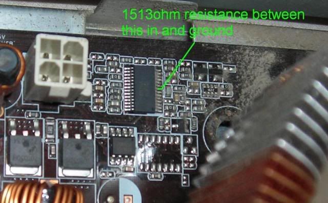

I would like some help volt modding my motherboard. I need to know what points to read from and what kind of resistor to use? I have took some pics of my motherboard, and have a good idea where my vcore is (shown in the the pic below).
Maxx voltage via bios is 1.95vdimm and 1.25vcore.

ok i got the vcore modded, and it worked! woot! i have yet to try vdimm but thats soon to come.
anyways for anyone else trying to mod this board here's the diagram i usedhttp://www.fly-well.com.tw/Products/...ek/RT9246A.pdf. you want to solder the resistor between the "FB" pin and ground, and reduce the resistance to in increase the volts.
