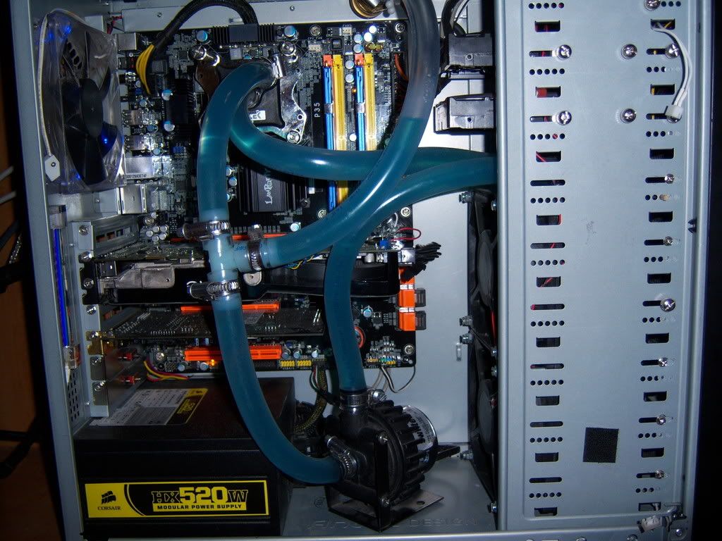

T line loop:
From cheap tubing and blue dye. (I used pentosin)

It is a combination of the dye and whatever happens to cheap tubing, lol. The white opaqueness is common even if you are using distilled with no dyes. I am not sure what causes it, but it is usually a sign of cheap tubing. Now, that was after months and months of 24/7 operation. I am pretty sure that tubing was from Lowes, too.

Just put the T line where the res would be. T>pump>rad>CPU>T The main thing is to have the inlet (either T or res) right before the pump and to have the rad right before the CPU.
