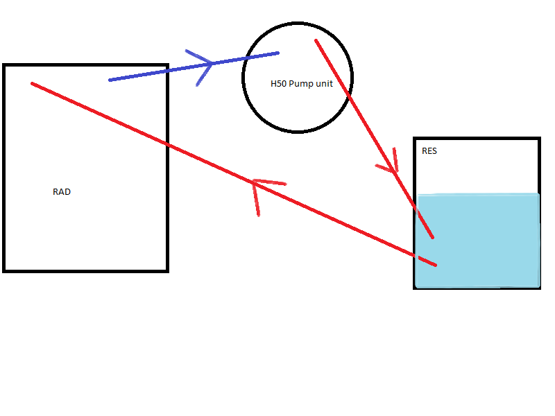

we are agreed with this .. but since the H50 has Pump & water block at the same unit , we'll consider it as water block.
Now. is there any meaning for the HOT water to go first to the Res before going to the Rad ??
I see this saying is correct:
for best performance youd go from your Res -> pump -> waterblock -> rad -> res
which is the same with diagram of second pic .

I want to do this. Is it safe for the H50?
yes it is, if you do it right.
Originally Posted by galaxyy
I would think it would be better to draw the water from the res than from the rad. I don't know if anyone has tested, but it seems more logical to go:
Res > Block/Pump > Rad
yes ,, this seems more logical like in the second pic.
btw i have done the first diagram with no improvement , will move to the second diagram, i think it would be much better.

2,883 Posts
Problem I see is if you're pulling water from the rad to the waterblock/pump and then into the res, there is essentially no pressure to push back into the line to the rad.
It looks like you're going to have to push into the rad and pull from the res.
EDIT: Nevermind, its 5:40 am and I just realized what I was saying lol
I think I was right anyway.
