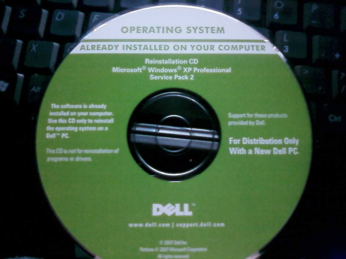

Thanks for the help guys. One more question. I didn't find my eeepc XP disk, but I did find the one pictured below from my XPS. It's 32-bit. Will it work?
is it a dell laptop? Dell branded media is locked to Dell BIOS, so it wont install unless the BIOS is froma Dell computer.

That is wrong my friend, Ive used dell discs on hp/compaqs before with no problems.
Actually, it is. It's old though. Will it make a difference?

Then the Dell cd will work perfect and wont even ask for the key.

Every Dell disc I have ever used on a non DELL computer gives me an error when setup starts saying that the disc is meant for a DELL computer only. HP/COmpaq may use the same OEM BIOS code as a DELL, who knows. I have tried DELL CDs on custom built PCs just because I needed to do a repair install and it was the first CD I found (with a legit OEM Key) and it hasn't ever let me into windows setup.
Well... it worked! Now it's off to find drivers...
