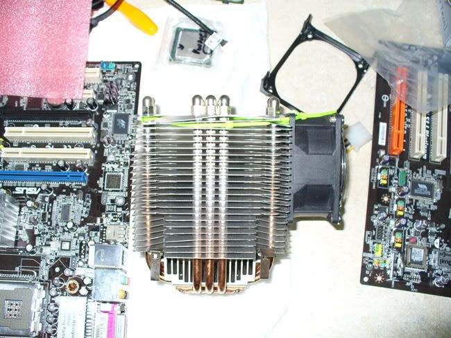

Tired of having to listen to a whiny 92mm fan on your CPU cooler just because that is the fan that came with it (or because your case is narrow like mine and will not fit a 120mm based CPU cooler)? Dump the 92mm fan and slap on a 120mm baby! Materials needed:
- 2 to 4 twisty ties
- a somewhat quiet fan able to move decent cfm (I used an Ultra Kaze 2000 running on a fan controller @ 1,750rpm and it cannot be heard over the other fans. Note this is a 120x38mm fan so make sure you have the room needed in front of your CPU cooler!).
Results: -8C CPU @ load. When I installed my Vendetta, CPU temps at load were 55C with the 92mm fan. Once I twisty tied the 120mm, my temps droped to 47C max (running Orthos Small FFTs). The beauty with my setup is that the fan pretty much free hangs a couple of mm in front of the CPU cooler and causes zero vibrations, thus even less noise…and no whine (I hate whine!!!)

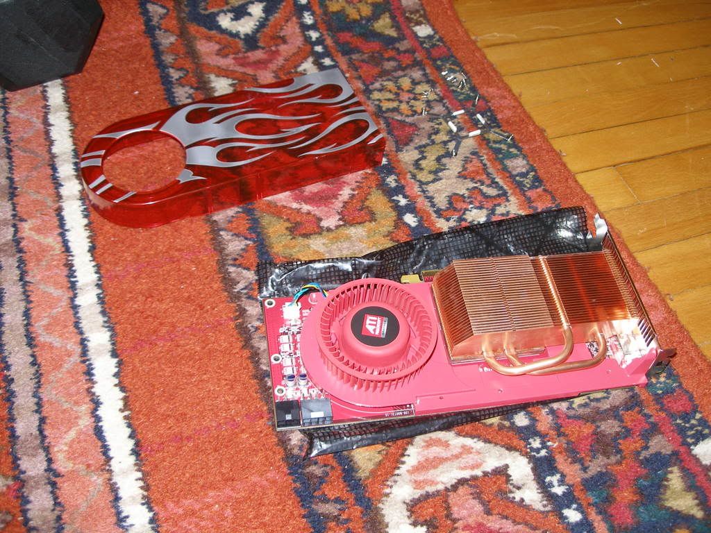

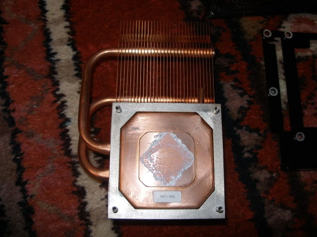

If not, here's some pics of my yet unpublished : Replacing thermal poop on video cards with the real stuff! 5C off if you do it well! Also, no hurt to your warranty!
Dosen't removing the heatsink void the warranty?
Ifnot - i'll do this also to my 2 HD3870's [Artic Silver 5 ok?]

It does, but then (hopefully) you put it back on. Unlike an Xbox 360, they don't have a secret way to find out from a million miles away. How would they know you replaced their crap TIM
